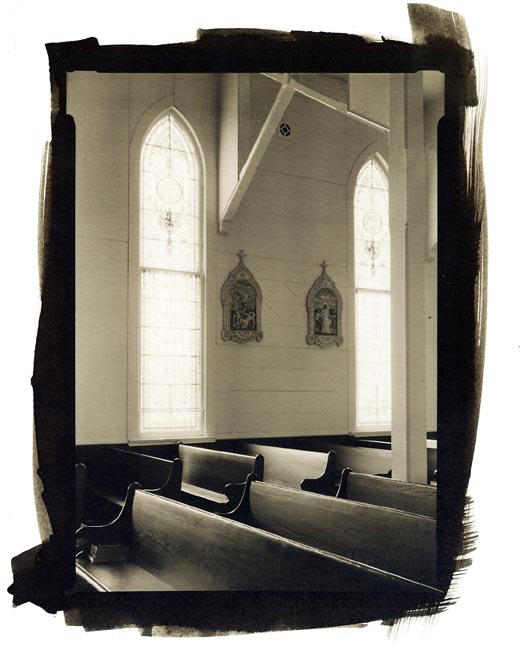

A slightly different view of Matt's 7x17 from the same church. Finally got around to mixing up some LiPd and printing. This is the first DOP print I have made (there were a couple of trials before this), since in the past I was doing Ziatypes (POP) prints. Comments welcomed.
Westphalia, TX
B&J 5x7 back, Caltar 150mm
2 min @ f32
Efke PL100 in Pyrocat 2+2+100
Arches Platine, 8 drops of FO + 8 drops LiPd Exposure for 18 mins.
Dont you jsut love 5x7. Perfect fromat I swear. I like this image. Love the glow on the pews.
Mike, you've captured a wonderful feeling with the light here- very inviting.
All the best,
Daniel
Thank You for the comments guys...I do love the 5x7 format, it just fits, for me anyhow. Was quite pleased with the outcome of this, since it is only the 3rd attempt with DOP in palladium. Mixed everything last week, and attempted a couple at the end of the week, was a bit discouraged at first, then this one :smile: B I G difference to me between POP and DOP at least as far as expousre goes...POP is pretty easy, having to get new eyes for DOP.
This just glows! Whatever DOP or Pop is must work. I think the light is wonderful, Well seen!
Very nice. A good tonal range.
Thanks everyone, appreciate the kind words. Thomas, POP (printing out process - ie Ziatypes) vs DOP (develope out process - traditional palladium process), just more terms to keep us all confused - :wink: (like I don't have enough trouble with that everyday)
