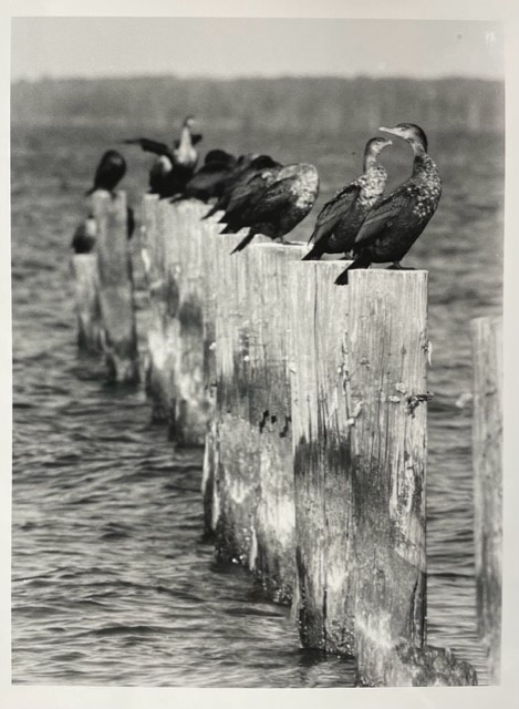

Really a test of Kentemere 400 in 35mm in Xtol. This frame exhibits a strange couple of spots near the near-most bird and in the sky to the right and up of it. I tried cleaning the negative with Kodak Movie Cleaner, but it did not remove the very round, clear deposits. It looks like emulsion.
Colonial Beach, Virginia
Nikon F5 with Tamron AF 200-400mm f/5.6 LD IF 75DN
Not recorded
Kentemere 400 in Xtol 1:1, Processed in Jobo @ 68 (ish) degrees 12 min w/25 RPM speed (forced start at 20.4C, as I was impatient)
Ilford MGRC Deluxe Glosssy in Replenished Ethol LPD 1:1 - sorry, this is a crappy iPhone snap edited to upload.
None (Ilford Contrast filer 2.5 on enlarger on all this series)
