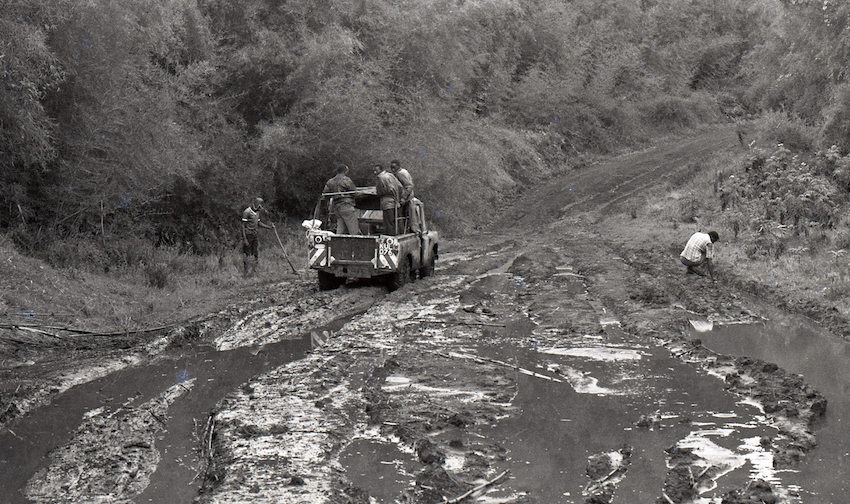

An experiment in re-washing film. I developed this film in 1994 but I never printed it. It was left in a drawer, uncut and I found it last week filthy and creased. It was clear that any technique based on wiping the film would cause damage. Also playing with scan settings.

Kodak T-Max 5053 (400?)
Probably T-Max Dev

So the re-washing in tap water and Ilfotol has helped a lot. It also helped with some of the sharp creases which became last noticeable as the film dried with a weight attached to the bottom of the film. Negatives are still dirty. Scan settings are not right. This one scanned in 24 bit colour which has picked up grease on the film as a bluish mark (like oil on water). Would have been better in grayscale. Scanner, Epson V800. I knew re-washing might have resulted in catastrophe but I got away with it.

If it had been of great sentimental value I would have scanned the film "as is" so at least I had something and then tried the re-wash. Those are Kenyan army chaps standing on the Land Rover. A few hundred yards up the road they were well and truly stuck and not looking so pleased with themselves. We pulled them out but then our Land Rover caught fire....
Yes only a scan but that is how it will have to be going forward. I no longer have a room suitable as a darkroom so printing is not possible. Developing film on the other hand is fine using a changing bag for the obligatory dark stages. Having said that, I don't think I would cope with loading films on spiral reels in a changing bag if I hadn't learned how to do it in the space of a darkroom first.
