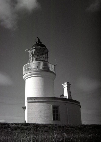

Chanonry Point
A trial film run through a recently purchased Nikonos lVa, but also a trial of XP2 in Rodinal due to local supermarket no longer doing film developing.
Nikonos lVa & 35mm
Ilford XP2 in Rodinal 1+25 for 18 mins
And that's a good trial, to me! As far as the scan can tell, maybe a tiny bit too much contrast, but the tonality looks really pleasing! And the composition of tones was nicely done on your part.
Thanks Marco. I should also have said it is a scanned negative, so a print could have reduced contrast.
If you're going to be processing film at home, in conventional black and white developers, XP2 (a chromogenic film) is a poor choice. Try HP5+ or FP4+ if you have access to the Ilford line.
