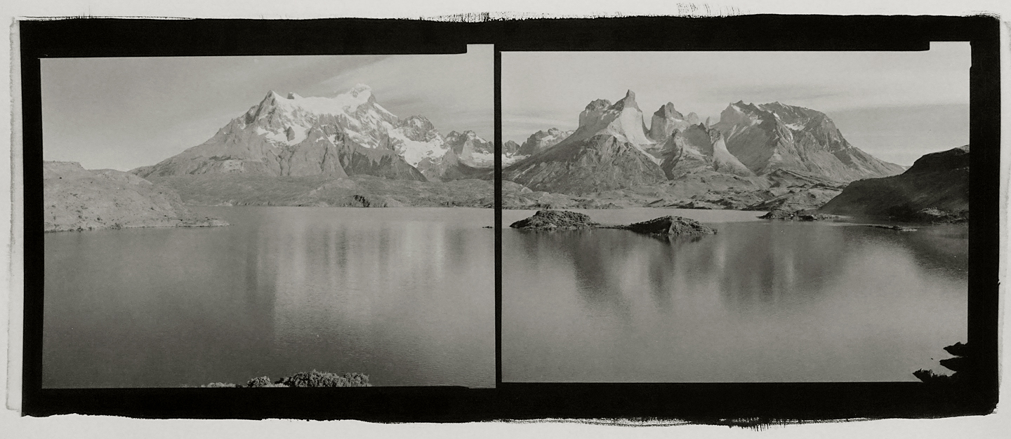

Two 5x7 negatives, Platinum/palladium print
Parque Nacional Torres del Pain, Chile
5x7 Eastman View No.2, Computar 210/6.3, old Gitzo Reporter
f/16 at 1/8 sec
FP4+, PyrocatHD in Expert drum
Hahnemuhle Premium Rag, Potassium oxalate at 110F
Red -- 25a
And trimming of a negative...
But what is nice about the print, is that up close (magnifying glass close), is that one can see individual waves on the lake that over-all create a shimmer on the print surface. Alas, limited by the computer screen. Everything is tack sharp, but muted by the paper surface and the tonality. It is an interesting mix of qualities.
This is early morning light. My boys were hiking up a large hill off to the right for the view. Dust from the first tourist vans/buses can be seen on the far right -- I worried about it at first, but it adds a little 'light' over there. Not nearly as dramatic light as the evening before, standing in the same place, wind blowing clouds off the mountains as fast as the mountains created them, and the lake whipped up. Not the classic still lake with reflections of the mountains as clear as the real thing. I love the way the lake surface is alive in its own right, with the mountains adding to the dancing of the light off its surface.
The foreground of each negative has a touch of the earth (rock and vegetation). I remember wanting to keep some in the image in order to give the viewer a connection to the earth to better enjoy the distance.
Yes the shimmered reflection of the mountains on the lake looks wonderful. Great choice in filter, just gives enough contrast with out being over bearing. I wonder if a digital camera photo would do a better job than the scanner. Anyway keep them coming, the landscapes of this country are amazing and its alway good to see them in mono tones.
I used my digital camera -- too long for my scanner/copier. Unfortunately I do not have a good copy set-up. The camera is probably better than I am (Sony RX100 IV). hand-held, ASA bumped up, meager lighting, poor photoshop skills.
