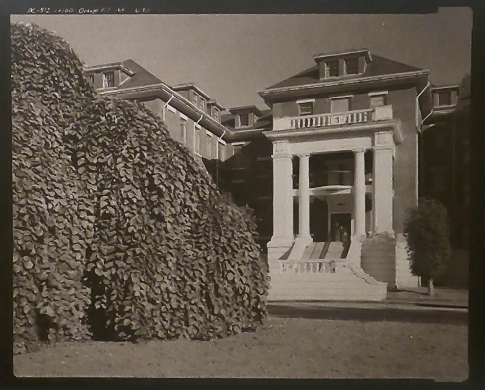

Kallitype print from an X-RAY neg exposed through an orange #21 filter. Thread & Video here: https://www.photrio.com/forum/threads/x-ray-red-filter.214998/#post-2916114
Riverview grounds
Canham 8x10 Light Weight
Long
Agfa green; PC-512 Borax
Revere Platinum: Sodium Citrate
Orange #21 (factor of 16)

I like the yellow filter the best. The whites are a bit dull and lacking contrast in the O&R filters. Also, the wall behind the tree on the far right and the tree shadow on the stairs are more visible & better defined. Basically, the tonal range is more to my liking w/ yellow filter for this specific scene.
Lovely print Andy. You've inspired me to break out my 8x10 and cut some X-Ray film for it.
