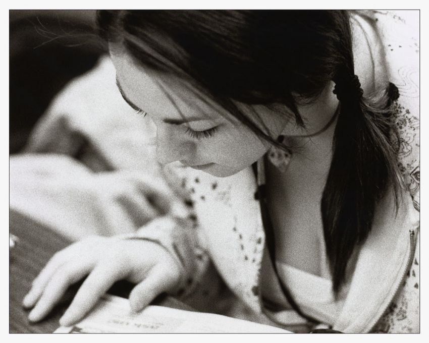

so...what happens when you accidentally pour part B of Diafine into the tank first? After realizing my mistake, I proceeded to rinse the film for 1 minute, used part A for 4 minutes, then part B again for 3 minutes, rinsed and fixed. I had to discard the part A because of the contamination, but I think the negatives came out alright. What do you think?
Rockland, NY
Canon A-1, 85mm lens
f2.8, 1/250sec
Ilford HP5 (EI 1200), Diafine
Forte Polywarmtone RC, Formulary 130
none
Seems fine. I've seen some strange effects from people using B then A. Almost looks a bit sabattier effect at times. I've not tried that EI combination with Diafine, it has a nice grain to it.
the grain comes up with the push, though the reversing of the parts seemed to soften it a touch
