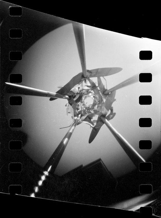

This is one of the test shots from a weekend outside while it was still light. Film used was Ultratec that I cut up into little strips and stored in an old metal film canister, and had a second film canister to hold the exposed strips as I changed them out in a very small changing bag.
This view is set by placing the lenscap combination facing straight up into a streetlight display in Gaslight village and letting it expose for 30 seconds.
I choose ultratec as opposed to kodalith as I've originally tested indoors because 1) I could just bulk roll it into a reloadible canister and cut from there, and 2) it is orthochromatic as such I can develop by inspection in a tray.
I did find that I changed my exposure methodology a little, and exposed it for ISO 12 (ie: 30 second exposure) As opposed to ISO 6 (1 minute exposure) To get shorter exposure time, however I remembered too late that ultratec does not like being shot at ISO 12, it prefers 3 to 6, or it gets development stains and other issues.
At least one more Test submissions coming soon.
Gaslight Village, GR, Mi
CapCamV2
30 Sec @ ISO 12
Dektol Stock (somewhat exhausted)
