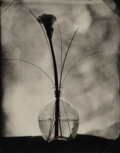

Another from the ongoing series on my studio windowsill... 11x14 wet plate collodion on aluminum
Upstairs
Korona 11x14, Dallmeyer 3A
6 sec, medium stop
collodion
aluminum

How are you mounting these these?
Also-are you using any light other than the windowlight.

Thanks, guys - I appreciate the feedback. Vic - I am mounting these by first attaching a piece of 4-ply mattboard a little smaller than the plate to the back of the plate. I then mount the plate/mattboard to a larger board (usually 20x24 for 11x14 plates). This gives the appearance of the plate floating above the mount board. I then overmat with 8-ply board leaving about 1/2 inch all around the plate. And I'm not using any additional lighting other than the ambient light bouncing around the room, which has a couple of skylights in addition to the window.

Very nice. I like how the vase provides a softeness and slight blurring of the stem above the water line and then renders the stem sharper in the water. I also like the backdrop. Is that something over window itself, or an effect of the lens depth of field recording clouds slightly out of foucs? Either way I like it.
Thanks again. Jim - there is nothing on the window, except some dirt on the outside. What you're seeing is mostly severely out of focus trees and some sky (no clouds) in between them, combined with effects imparted by the developer flowing over the plate. Did I mention how much I love this process????
