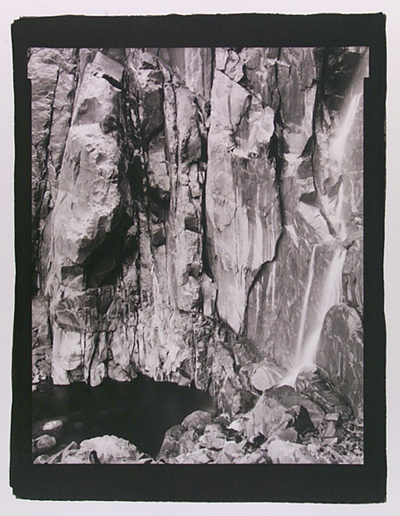

First upload -- here I go.
The Base of Bridalveil Falls, Yosemite National Park
Platinum/palladium Print from an 8x10 camera neg. No contrast agent used.
The scene metered from 5 to 10 on my Pentax Digital Spot -- exposed at 8
Zone VI 8x10 w/ Fuji W 300mm
f32 at 4 seconds
FP4 at 125ASA Ilford Universal PQ Developer in a Jobo drum. 1:9 dilution, 70F for 15 min.
pt/pd on Fabriano Artistico (acid treated), PO developer - room temp
Very nice. I like the apparent sharpness and the contrast.

JW -- many Bridalveil Falls (and Bridal Veil Falls) I am sure! This print is at the limits of acceptable contrast for a pt/pd print. Any more contrast in the neg and I'd have to go with a ziatype instead...or a carbon print. I have a hortizontal version that I made a nice carbon print with.
