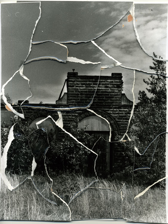

An abandoned quarry maintenance building just south of Amherst, OH. Trying my "Torn Paper" effect. Tore up paper and glued to back of old print. Then processed in normal manner.
South of Amherst, OH
Nikon F, 50mm f1.4 lens
Metered
Ilford FP4, Microphen
Adorama VC RC, generic Dektol
Medium Yellow
Could you run that by me again? You tore up the paper, glued it to something, then "processed in the normal manner"? What processing was that? I would have thought you tore up the print and then put the pieces back and rephotographed it. It's an interesting effect, but I don't understand what processing would come at the end.
I like this image & technique. I'm guessing you did the following: 1- Tear up a sheet of unexposed photo paper (under safelight); 2- Glue pieces onto an other paper (still under safelight); 3- Expose under enlarger as a normal sheet of photo paper, develop, etc. Am I correct? What did I win? :wink: This way the pieces are placed rather randomly, but the image itself is correct positioned on every piece. I like it!!
