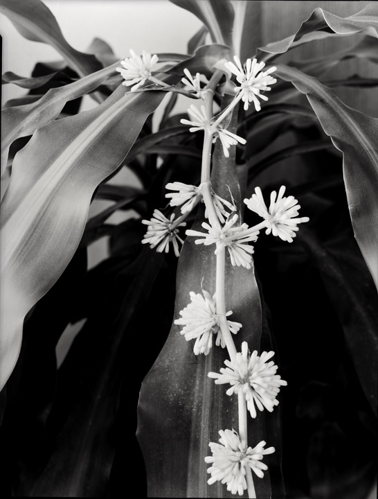

A lens test pure and simple. The 8.5 inch Cooke Series III had been laying around in a broken shutter for a couple of years. After repairing the shutter I wanted to see what this lens had. Mercy, if coverage weren't an issue I would leave the Dagor at home and bring this. On the 6.5X8.5 it's tight but certainly produced some exciting negs.
my house
Seneca 6.5X8.5 / Cooke Series III 8.5 inch f6.5 triplet
8 minutes f32+
Aerial Recon Panatomic X / Pyrocat HD
film scan but neg tailor made for Pt Pd
Jim, so many lenses so little time! This looks great to me. By the way I just got a +1 diopter for the Voigtlander Euroscop that makes it a 20" lens. A little gaffers tape around the edge and she screws right in. I'll post some shots as soon as I can. Thanks for the great recommendation.
Jim
Anxious to see what you do with that Jim. Very cool.
