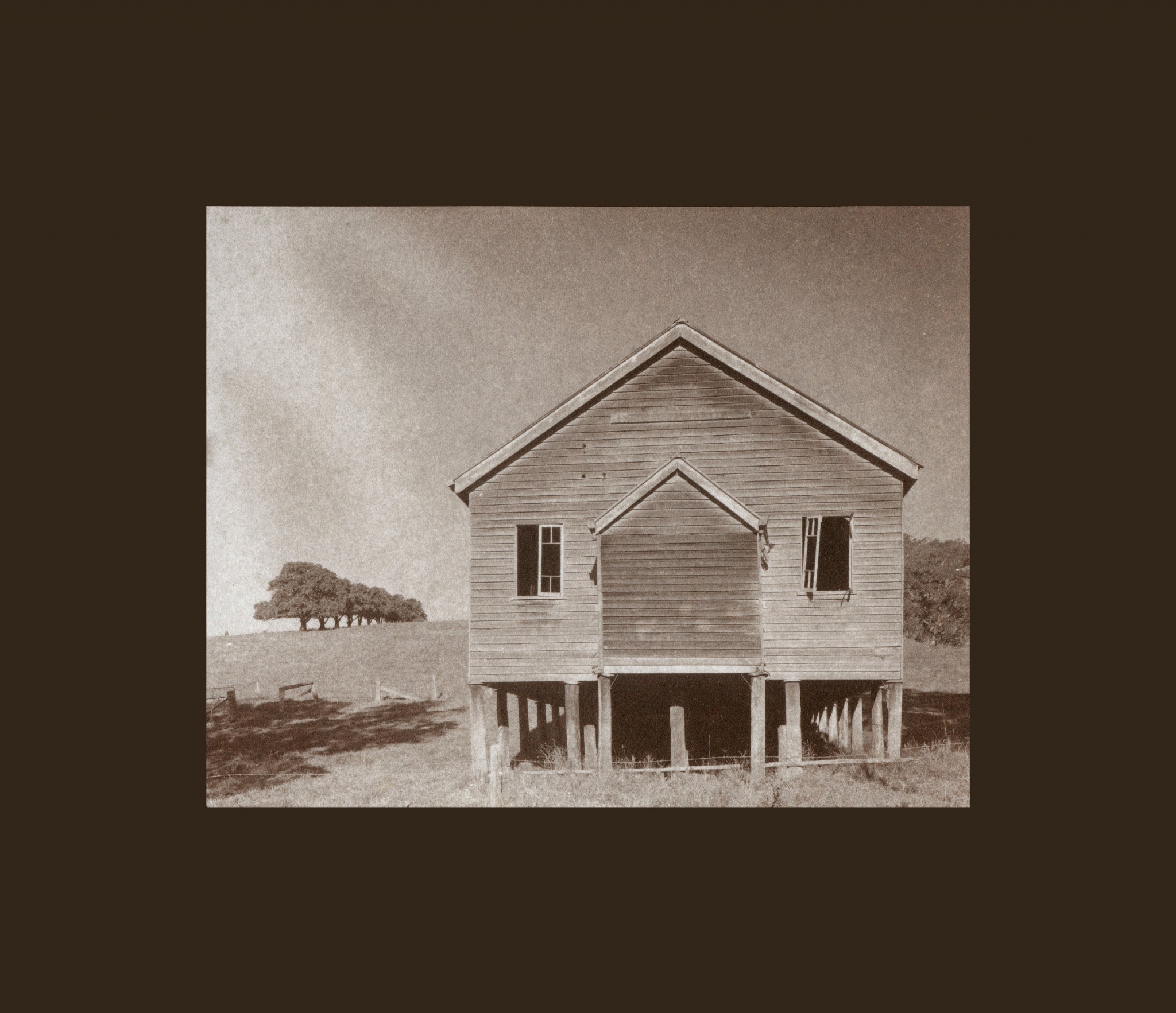

Vandyke Brown 4x5 contact print on cotton rag, weak gold and selenium toning. Did a darkroom print, but thought it would work better as a small print. Hence the large boarder to keep it small for viewing. Think over did the sun rays dodge....it works better if you click on image.
West
Sven (linhof technika iii 4x5) 150mm lens
f32
fp4 in pyrocat hd
cotton rag vandyke brown process, weak gold and selenium tone.
orange
Hybrid Materials & Processing
scan and boarder added
@pentaxuser Thanks, I mucked up 4 prints and this was a last do or die go and mid way through the long exposure I thought about adding some rays so quickly made a three figured dodge card the right shape and went about dodging for a few minutes. If I do again may refine.
