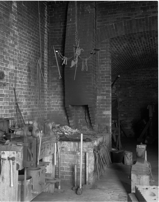

I wanted to see how N-2 worked out with a very dark scene. A new (used) shutter is a little sticky on bulb setting, fine otherwise. I will have to use the lens cap to end the exposure until it frees up.
Fernandina Beach, FL
Zone VI, Sironar-N 150mm f/5.6
6 sec @ f/32
TMY in HC110(E) - N-2 development
Epson V750 (hope it will wet-print as easily as it scanned)
Yellow
Heinz said:
Great tones for this scene! One can smell the ash.
But can you feel the heat? It was 95F without the forge operating. It was lit a week earlier - glad I wasn't there then.Thanks. I will have to return in a couple of months when it's not so hot. I hope the shutter loosens up by then.
