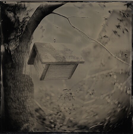

Back in the saddle again after a brief break to troubleshoot some problems with the process. I made 5 plates earlier today and this is one of the better ones. Not the most enthralling of subjects, but I needed to try some new developer. This time, no blue tones at all in ANY of the plates I poured. This one was using my own prepared collodion and my own prepared developer..Not the Bostick and Sullivan kit I was using.
Back yard
Chamonix and Darlot
1 second
collodion on aluminum
I really enjoy how you used the shape of the tree to coincide with the falloff of the lens. That is some very good eyes on your shoulders there, my friend.
Thanks Thomas... Just exploiting the lens signature :smile: This process has had me in fits trying to figure out where all the blue tones were coming from where it seriously shook my confidence. This shot is a little over exposed, but I was VERY surprised just how fast this collodion I made is. This was only a 1 second exposure @ F4 and could likely do with about a 1/4 or 1/2 a second instead!
I think it's a wonderful image, too. A technical question, not to be construed as criticism: Is the solarized appearance due to overexposure? Not having tried this process, I'm curious.

The overexposed/overdeveloped highlights look great against the almost pitch black vignetted corners. Maybe you have a unique way of shooting collodion this way?
