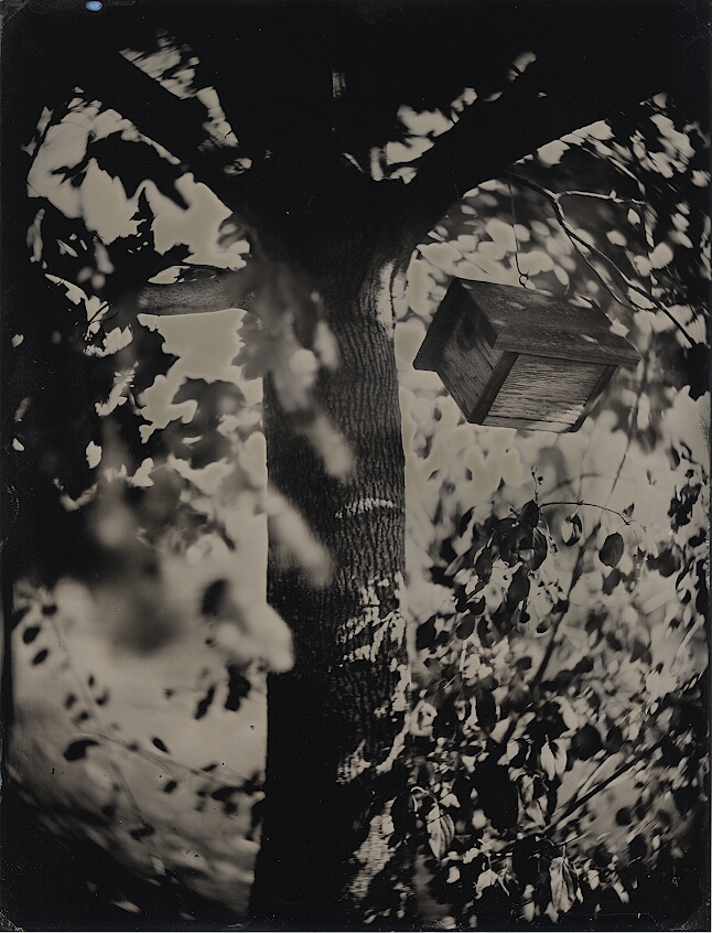

I've had a hectic schedule the last few weeks with the deer hunting... I had a lull at work and thought I'd pour a few plates.. This was in my back yard . I love the dappled light underneath the canopy of yellow leaves that are almost gone!
Back yard
Kodak 2D and Wollensak series A portrait @ F5
6 seconds @ F5
Collodion on Whole plate aluminum

Thanks everyone!! It's been over 3 weeks since I made any plates and was having withdrawal! I forgot to mention... In the last fiew times I've poured plates, I noticed they were getting a little muddy/less bright and overall dull... I'd heard that silver nitrate can help brighten up plates. So I added a few drops of silver nitrate to the developer as I pulled the plate from the silver bath by holding the drip corner towards my developer pouring vial...I added only about 3 drops. It seemed to work VERY well in overall brightening and makes a significant difference.
