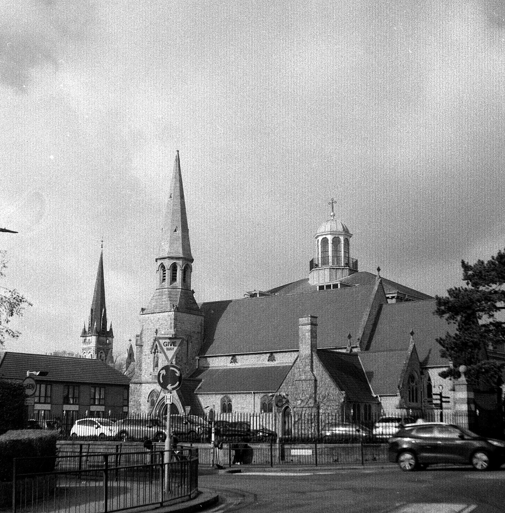

Given a German 'Voigtlander BESSA 66' with un-coated lens which is a bit 'hazy' but I cannot get into it to deep clean. Most negs on roll were dense and 'Foggy looking' Anglican and Catholic Cathedral in Brentwood. I used Yellow Filter but neg was very dense and scan is poor. Shutter running 'Slow'
BRENTWOOD Essex England
Voigtlander BESSA 66 + 75mm f3.5 'Voigtar' lens
1/300th @ f8
outdated AGFA APX 400 in home-made Crawley Formula FX-4 1+1 11 mins @ 20oC
Neg Scan
Yellow
Epson 1650 flatbed scanner + Vuescan Pro + FastStone Image Viewer.
You can see how 'Blurred' the black car on RIGHT edge is -- if shutter WAS 1/300th it would be sharper-- more 'Tests' to follow -- even in 'Technicolor'!!
@pentaxpete Looks like your scanner is giving up, that banding can't be normal. If it has a scanning head with more than one CCD, it might be that they are out of calibration. My Nikon scan does that...
Yes -- I get that 'Banding' when the Negative is DENSE as was THIS one.
