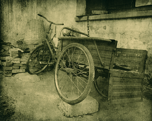

Beijing Tricycle 2006 Lith
Submission for the APUG Alternative Print Exchange
Beijing, China
Bronica GS-1 65mm Lens
1/125 @ F4.5
Fuji Acros in Pyro W2D2+ 9 minutes @ 68?F
Fotospeed Lith Paper in Fotospeed LD20 Lith Developer
Must be amazing as a print!
Holy Moly - That's amazing - what a perfect treatment for this image.
Thank you everyone for all the great comments. This was my first real foray into Lith printing and I am quite excited about the possibilities. I tried out a few different types of paper and settled on the Fotospeed paper for this particular image. I encourage anyone interested in the process to just give it a try. It was incredibly fun, easy as regular printing (if regular printing is truly easy) and there is that little "magic" to snatching your image out of the developer at just the right point that makes you feel more involved. I also posted a scan of the negative for comparison if anyone is interested.

This is a beauty. I look forward to the postman coming :smile: This will be the first Lith print I have in my hand so I cant wait
