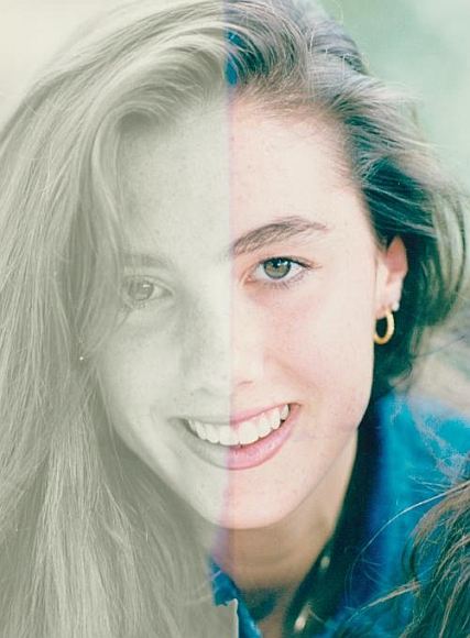

This was a process done by me several times in the late eighties. It's a technique to rescue thin colour negatives. Or to develop a colour print in front of an audience in daylight.
Basically you expose the paper with less exposure, develop, then fix in B&W fixer. Turn the lights on and then wash, bleach the print, wash, re-develop in colour developer. You can stop here, or do the process again and again until the you have developed all colour couplers that weren't developed the first or subsequent times.
Basically, you get a more colour saturated and contrastier print.
This actual print was hand processed in a tray on a table, in front of a rather amazed camera club meeting about 17/18 years ago, Hence the crude demarcation line.

Mick Incredible. What a great way to demonstrate colour printing. Just to make sure I have understood the process: It's all B&W at first. The bleach is pot ferri(?) then redevelopment in col dev. until satisfied. Does blix play no part in this? Once the print has been col developed to your satisfaction, what fixing, if any takes place?
Sorry if Qs are dumb but my chemistry knowledge is non existent. Thanks for sharing this. It's one of the most novel things I've seen on APUG

I just realised I missed some little bit of info out.
You develop the paper in normal colour process, (in this case it was EP2) RA4 was the next and current colour neg paper developer.
Then I used my bog standard Ilford B&W paper fixer. You can turn the lights on here.
Then you bleach the print in colour paper bleach.
Then you fix the paper in standard colour paper fix.
What you have to understand is that Blix is something that was not the norm in older processes, at least not that normal.
This process is derived from an article by Patrick Dignan in the 1987 The Chemistry of Photography Volume II.
Robert Anderson then had an article in Perfect Colour Printing about boosting colour saturation and contrast in that 1990 publication. Both of these are Preston publications which published Photo Techniques.
Interesting what a bit of fiddling can achieve, eh?
By the way I also know very little about chemistry, I just read, then fiddle, fun things happen. Sometimes though, I just fiddle.
Mick.
