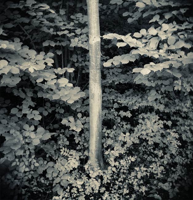

Toner: MT3 Vario for the lights, MT7 Iron Blue for the shadows
Bleach 1+30 15sec - T3a (bright yellow) - MT7 (5+5+12+5+500) 1min, final treatment ammonia solution (4ml/Liter) 20sec to shift the green shadows to blue
Kendenich, at the Pond
Holga 120N
f11 3sec
SFX & Finol
Adox Variotone & Amidol plus
RG715
the recipe you used to make this beautiful print seems quite sophisticated ... thanks for sharing ...
Miles
Very nice
I keep waiting for one of your 'misses' so that I can feel better about myself. It appears as though I might be in for a long wait.
You are a harsh standard Wolfgang!!!!!
beautiful
monty
You have such a knack for making these come alive and sparkle. I'm very impressed. Every time!
