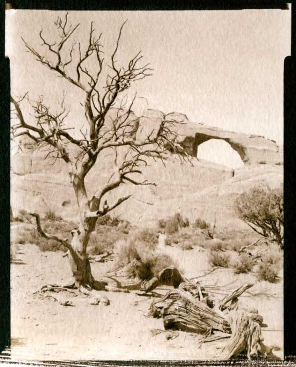

4x5 Kallitype on Rives BFK.
Arches N.P.
Toko 4x5 w/ 150mm sironar
Delta 100 in X-tol replenished
Rives BFK, Rochelle Salts
This one seems under exposed. no dark tones in the shadows
Thanks for the comments.
It is perhaps slightly overexposed and does need more contrast to get those shadows down a bit more. I was trying out borax / rochelle salt developer for the first time. I only had enough chemistry to make a liter, so I did not want to add restrainer as it was good for most of the images. I really like it though and have ordered more salts so that I can have a couple of more contrasty developers.
