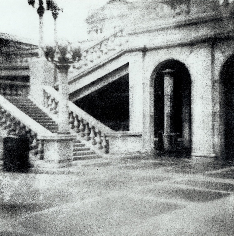

Another bromoil attempt.
eddie
Bromoil from Diana negative (Harrisburg, PA). I have a long way to go with this process.
you have the blacks nicely nailed... I think if you use some softer ink, you could get some more details in the highlights...But nice one.
Thanks fellas...Emil- thanks. You've answered one of my questions. Never having done it it's hard to determine soft from hard. I'll re-ink this with a softer ink.
A nice attempt and I would suggest you may improve the tonal range by starting with a much softer print.
Clive - its a print I usually print at 3.5. This was done on grade 2 paper. The Diana negative is pretty soft to begin with.
Well done, Eddie! The technique suits the subject matter very nicely.
