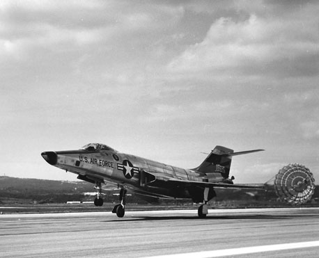

When and where was this photograph taken?

You know what would be interesting, if you don't mind sharing, is how people actually used Speed Graphics for this type of work. From what I understand about Weegee, it was f/16 and heavy flash and most things are in focus. Did you usually use Speeds handheld? Tripod? Did you use one of those sports finders? Did you remember what film that was available then? Its fascinating that people today, think they can't photograph this type of subject with anything but a honking SLR and AF.
At that time, I was using the SG handheld. I had a Nikon F with the old zoom lens about 2 feet long. The SG had Super XX film in packs and the Nikon was using E2, 160 Ektachrome. Ground and aerial shots from these missions were posted here.
Most of the posts were from original negatives which were unclassified. The classified photos were retained, of course, by the AF.
The exposure was determined by using a GE meter, which I still have. I shot both films at ASA 160, IIRC. Whatever it was, was the same for both films. I would have used the ASA for the reversal film to get the best exposure as the Super XX would have been more forgiving.
None of my shots were ever from a tripod. I used shutter preference due to the extreme speed of the subjects in most cases.
After this shot was taken, I was arrested for taking photographs in a restricted area. The NCOIC in charge had lost my permit confirmation and taken leave to go duck hunting of all things, so I spent the afternoon in a military jail until they could contact him.

The Nikon F was my own property, as was the GE meter. The AF did not supply 35mm to my unit and our light meter was a piece of junk. I don't even remember what kind it was. The Speed Graphic was just fine but a bit beat.
The FP shutter ripped while one of my guys was out doing a shoot but he switched over to using the leaf shutter. He said that 'rip flabadabadaba' alterted him to the failure.
