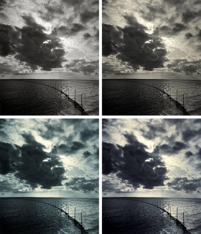

Adox Mcc - Steps To Yellow-blue-split
Wolfgang Moersch
Print onto Adox MCC in SE1 Sepia
right MT3 Vario Schwefeltoner (thiourea) - bleach 1+70 20 secs, toner setting "A" bright yellow 30 secs
below followed by MT7 Iron Blue Toner - right side aftertreatment in ammonia solution (dilution1+250) 40 secs

I'll confess I don't understand what I'm looking at here. Are we being shown how to achieve four different looks, or is this a progression from the initial print (upper left?) to final print (lower right?).
