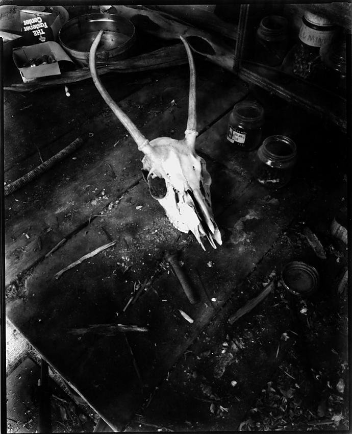

Second test of new camera. Still sorting out light leaks. Now in "Light Out" version 3.0. Will know soon if new mwasures worked.
Texas Hill Country
8X10 DIY Pinhole camera
Chevy 40 seconds, skull 1 hour 20 minutes
Delta 100, DD-X
Ilford RC and cool tone developer
I thought pinhole cameras were SUPPOSED to leak... :smile: This is nice and sharp, with very little distortion... what is your focal length?
215mm at approx f 331. The pinhole is a Skink pinhole and yes, the images are sharp. The light leaks make me a little crazy as I didn't intend to build them into my camera.
It's pretty amazing how sharp and clear a contact print from an 8x10" pinhole camera can be. Good job!
