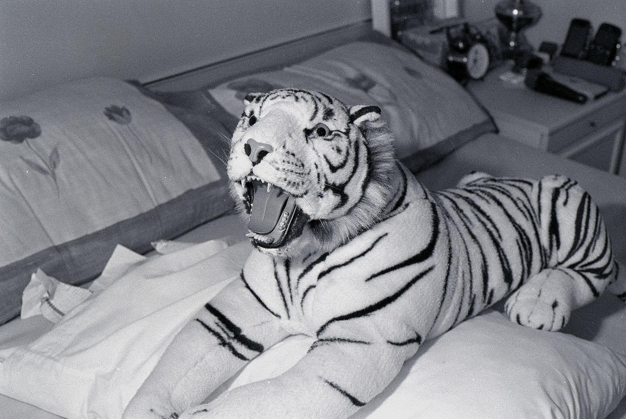

510 - Pyro Agfa APX 400 FRESH ! Dated February 2023
pentaxpete
I thought I would try some FRESH film at 1;200 dilution of the Home-Made 510-Pyo as I made up enough for 3 films in Paterson Major 11 tanks -- time was 'Guessed' !
BRENTWOOD Essex ENGLAND
CANON FTbn + 50mm f1.5 SSC Canon + Vivitar 283 Flash off camera with diffuser
1/60 @ f5.6
AGFA APX 400 dated February 2023 in home-made 510-Pyro 1:200 for 12 mins @ 20oC
NEG SCAN
NONE
SCANNER : CANON 9000F Mk II + Vuescan Pro + FastStone Image Viewer Straight Scan only down-size
Pete, the highlights on both the sheets and tiger are very bright and yet not overexposed or overdeveloped as I can see texture in both. At this level of brightness I had expected to see a virtual featureless white. If this can be replicated in a print then this might be a real feature and benefit of Pyro 510
My concern these days based on what I have seen written on the effects of scanning is whether this can be translated into darkroom paper prints
@pentaxuser If that texture is in there on the scan I believe it should also be very printable with maybe a little work. Any stain also helps hide grain somewhat. Couple of pluses for pyro developers. JohnW
@John Wiegerink Thanks so which aspects of a scan should I be sceptical about in terms what I see in terms of what is possible in a darkroom? I seem to hear plenty in posts to make me doubt the value of any scan in terms of how scans can represent a darkroom print. This phenomenon of scanning artefacts causing flawed representation of the darkroom equivalent print seems to surface all the time
