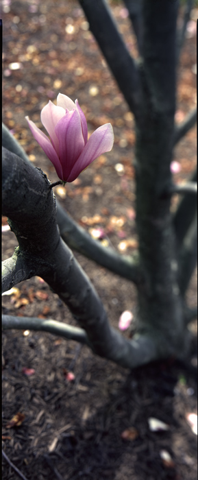

My last magnolia slide for now, I swear!
Actually, I am relieved that these things are out of bloom now, their noxious scent was killing me.
Anyway, this is a test of 4x10 slide. The local lab actually can't do 4x10, so I stapled the slide to an 8x10 piece with a cutout window and they processed that. Processing went went ok, except my plastic (transparency stock) got crinkly in the E6 process, so I plan simply to use cleared film next time. The staples took the heat and chems like a champ, just a little corrosion onto the film itself but not much. I'd say I lost about 5mm at the top and bottom of the 4x10 sheet.
Still experimenting with how to use the long aspect ratio effectively.... an enjoyable challenge, actually.
Back yard, Virginia
Shen Hao 4x10, Nikkor-SW 150
Astia 100f
slide scan
