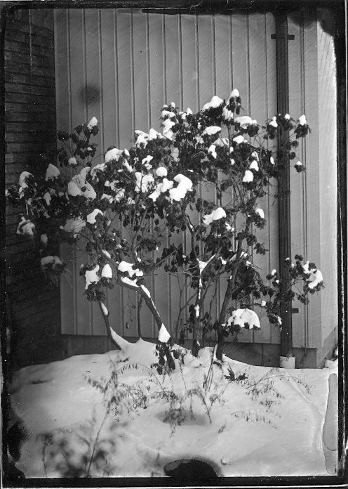

1st glass wet plate!
holy sh!t i did it!
my 1st ever lass negative. i kind of broke most of the "rules". i am using my "positive" collodion, developer and fix! i subbed the edge of the plate with my albumen mix. developed for 10 sec.
i took the neg outside and shot it with my digital camera (still wet!) and then inverted it in PS....nothing fancy! i am too excited to wait any longer!
note that i splashed a bit of water on the plate in the drying rack before i poured the collodion. i have a few issues but i got something anyway!
man, this is great!
please note i updated the neg scan with a scan of my print (refresh your page)
century universal 8x10, 5x7 back 12 inch turner reich
8 sec at f7
collodion. sugar developer. KCN fix
ilford warmtone MG
