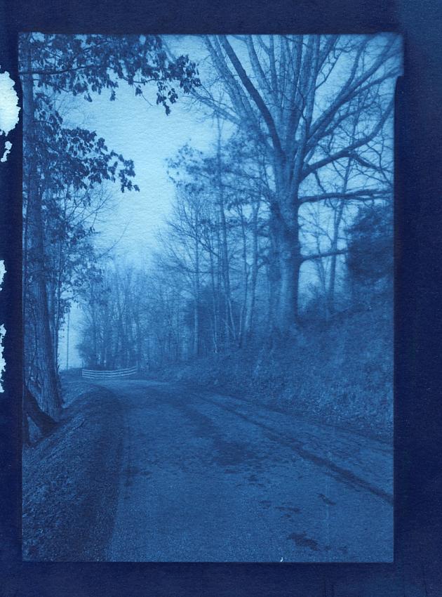

1st cyanotypes
JPJackson
1st cyanotypes
new cyanotype -
Johnson Co TN
Deardorff 4x5 Special; 5x7 back, 120mm lens
F32 1/2 second
FP4+ - Xtol 1+0
Stonehenge 110; 1% HCL
#6 Yellow
Nice! Keep up the good work.
Well done. Don't stop now.
This is gorgeous! Great match with image and process. The cyanotype really creates a nice mood for the image. David
Thank you all for your kind words of support! I have been studying this for awhile (C. James 3rd ed. and M. Ware "Cyanomicon"). This is a "designated" negative; developed to match the ES of the sensitizer. Have to say i am hooked!
