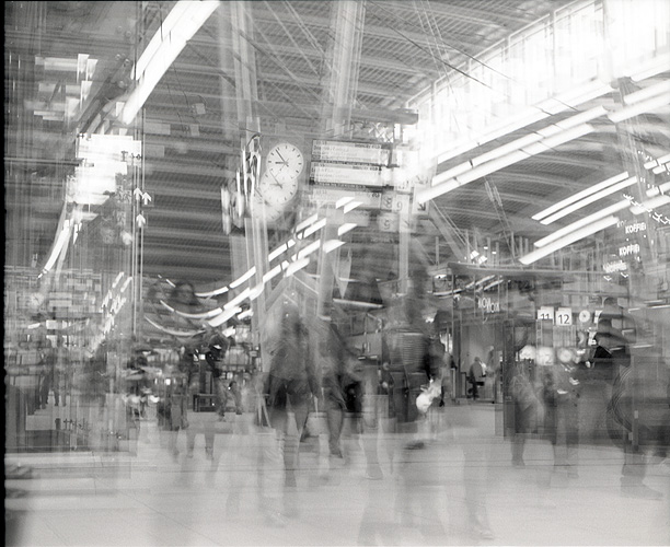

I sat on a bench at central station and tried a multiple exposure as an experiment, to see how this will work out. It was hard to keep the camera steady, transport film and cock shutter without tripod. I measured available light, divided the shutter speed by 5 and made 5 exposures on one negative.
Central Station, Utrecht, The Netherlands, 08.53 PM
Mamiya RB67 with 127 mm lens
five exposures of f8 @ 1/125 sec.
Kodak Tri-X, Ilford Ilfotec DD-X
straight scan from negative
none
Interesting. The more you stare at this image the more detailed the story it creates in your mind.
I will have to try this sometime, although I doubt I'll be able to catch the feelings of both motion and emotion I see in your first try.
'Looks like the exposure method worked awfully well.
