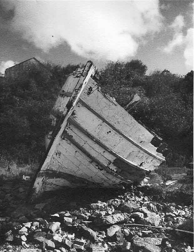

Images of an a boat in the quay of Belmullet Mayo Ireland, any advice as to how to try and take that black spot out of the cloud ?

The black spot can be scraped away with a fine scalpel blade or removed with a bleach like Farmers reducer. It needs a bit of skill to retouch with a blade but it's not difficult.

Hi guys, thanks for the advice, using a blade makes me nervous, will I really be able to repair the print without it being noticed ?
There is another way to remove that spot, providing the print has not been toned in any way. You will need some ferricyanide bleach and a very fine brush. Empty a few granuals of the ferri on to a dish or something similar, and with a fine tipped damp brush, lift just one granual of the ferri with the tip of the brush (it should just stick to it), and very carefully, using a magnifier if needed, lower the tip of the brush on to the black spot. Dab untill you have removed the black spot. The spot will need to be fixed by either dabbing fresh fixer from a cotton wool ball on to it, or refixing the whole print. Of course, it goes with out saying that the print will need to be re-washed in your usual way, and the remaining white spot then spotted when the print is dry. This works better if you work on a dry print, because if the print is wet, the bleach will bleed out to a wider area. I find this very controllable and easy to do with very little practice. Try to keep the brush as verticle as possible. I hope this helps.

Hi guys, that worked a treat so far, I've to try a little dye to repair the little scratch, thanks for the help, Paul
