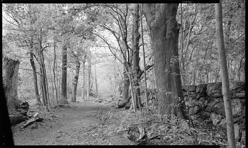

This was my second shot with the Korona 12x20.
I learned allot on this one. As you can see i found the end of the image circle trying out the swing.
480mm Apo Nikkor f/90 @ 16". Lots of rise and rear swing.

make sure that it is the image circle. I had the same thing on my 11x14 and it is the bellows getting in the way of the image. Sorry but I think this is the problem. image circle is round not straight line like this. How to fix it is something I'm trying to figure out and if someone knows i hope they post because I have not used my 11x14 since and am waiting to get enought money to send the camera out to get a new bellows.
P.S. I use a 480mm nikkor on my 8x20 and love it I think you got the right lens for this camera.
michael andersen
I think Michael is spot on. I've had these sorts of issues with my 12x20 Folmer & Schwing as well.
The best and most simple solution (and the one I still employ) is to just buy a couple small "c" clamps from Home Depot and compress the bellows and clamp a few of the pleats together in order to pull the bellows near the rear standard out of the frame.
More often than not, you can inspect the edges of your groundglass under the darkcloth and see if the bellows are getting into the image area, if they are, clamp them together, and then check the GG again to make sure they are out of the way.
Nice to have another 12x20 shooter around here Ian. Good luck continuing to work with the format. I look forward to seeing yer prints.
PS, another thing I just noticed, I saw your website link and another idea is possibly that your dark cloth is coming into the frame infront of the lens, obstructing the view. Just an idea.
I think your are probably correct Michael. I did swing it almost the entire way though.
The bellows are brand new from Turner Bellows in rochester. They did a fantastic job.
But at least i know what the problem is now. The dark cloth was posed for the shot on my site.
Since i am the shutter, it wasn't near the front standard.
