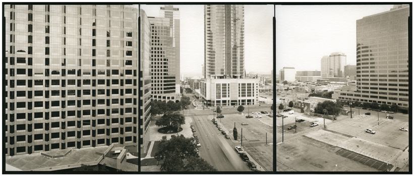

10x24 tryptich - downtown Austin, Texas
scootermm
8x10 (x3) tryptich from up on a parking garage near 2nd and Brazos.
Austin, TX
8x10 and 10" lens
3 secs each @ F64
Efke PL50 dev in PyroHD
Platinum/Palladium on Rives BFK
thanks fellas.
alignment was a bitch :smile:
Alignment looks great, particularly since you did it in camera. Did you do it with shift or by turning the camera (I'm guessing the latter)?
thanks david. I pivoted the camera. It a wide-ish lens (240mm/10in) so there is some distortion... but I'm okay with it. :smile:
