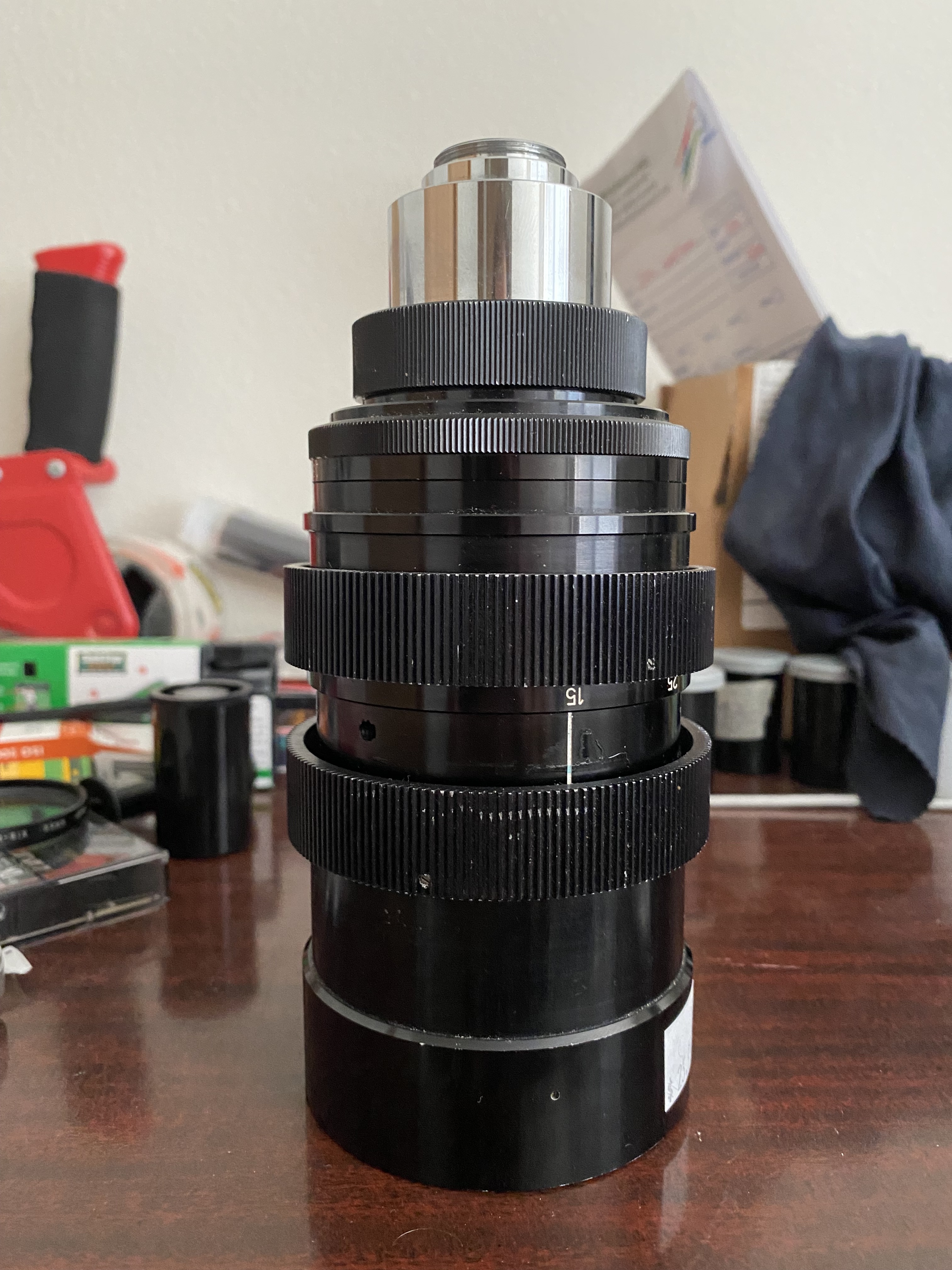

Picked this up over the summer for $26- it's a Canon TV 15-150mm 2.8-22 (with aperture close). I don't know much about cine/tv camera mounts, what kind of camera would this go to?
It’s most likely a C mount lens for a video TV camera. Looks like the lens can take various mounts with the proper adapter. While it is a “C “mount lens and will screw into a film camera’s C mount, be cautioned that the back focus may not correspond to a film cameras film plane. You’ll have to do some testing to make sure the focus marks on the lens match what you see in the viewfinder.
