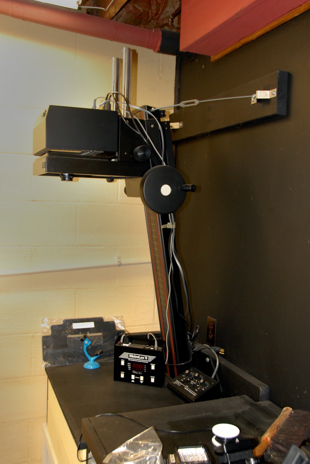

here's the photo that shows the most. Keep in mind that I haven't seen it, only the photos.

It does look smaller than my 8x10 model. (though just the same style).
It is a model 2.
I paid $400 for my 8X10. Often the price is related to the local market, as shipping is often viewed as a minus.

Ya thats mod 2,notice the two shafts comeing up above the head,those are the lens stage focus and supports. only one was used on the mod 1.How much is the person asking?

Nice setup! If I didn’t already have one (and if I lived closer), I’d be interested.
I see the Metrolux timer and the Zone VI controller, and the neg carrier seems to be the 6x17. There is also an enlarging lens visible on the head, which could be a 150mm (to match the neg carrier). The enlarger is the newer, more desirable Type 2, but the column seems to be the shorter one.
Based on what I can see, I think a price around $800 or so is fair. But I suspect that additional lenses, lensboards or neg carriers are included, which would raise the price.

I already have 2 Beselers. Though I'm tempted, I don't need it.
So you guys are sure the picture winger posted earlier is a 4x5?? I'm going out on a limb here and saying it looks like a 5x7 and winger may want this :wink:
Here is the 8x10 for comparison. So, I'm thinking the picture winger posted has a head just a little smaller than the one shown here and therefore is a 5x7:
