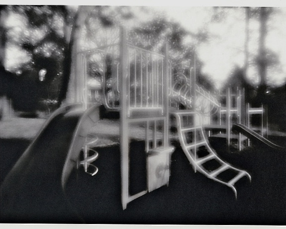

You may be interested to see what the zone plate setting is capable of. It's highly trial and error, to me anyway.
BTW I find the 50mm pinhole setup the most interesting, sometimes the 25mm can be extreme (watch out for the tripod in shot), the 75mm starts to look a little like a not so good LF wide angle lens.
