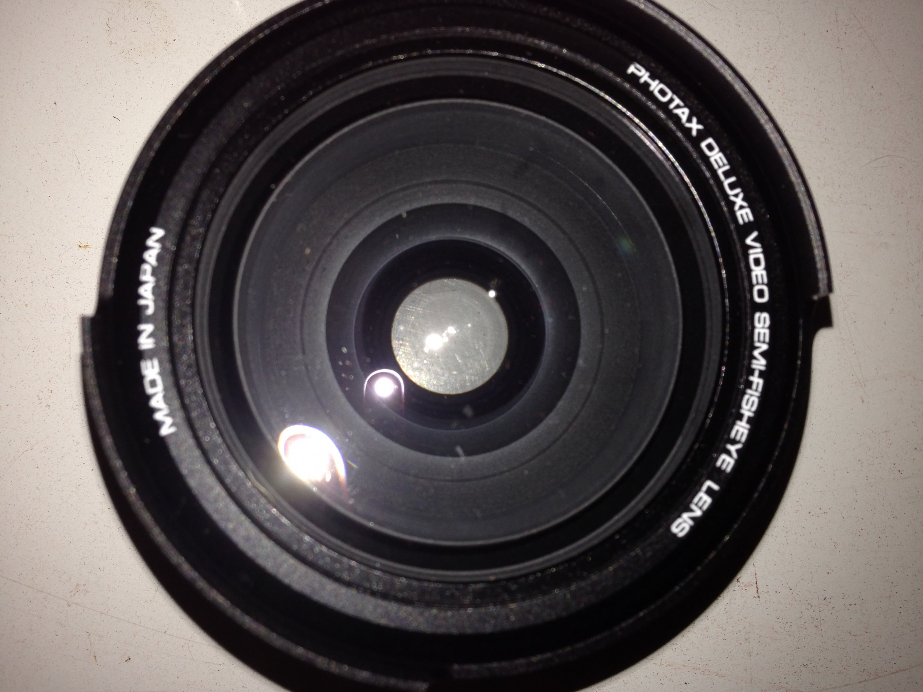

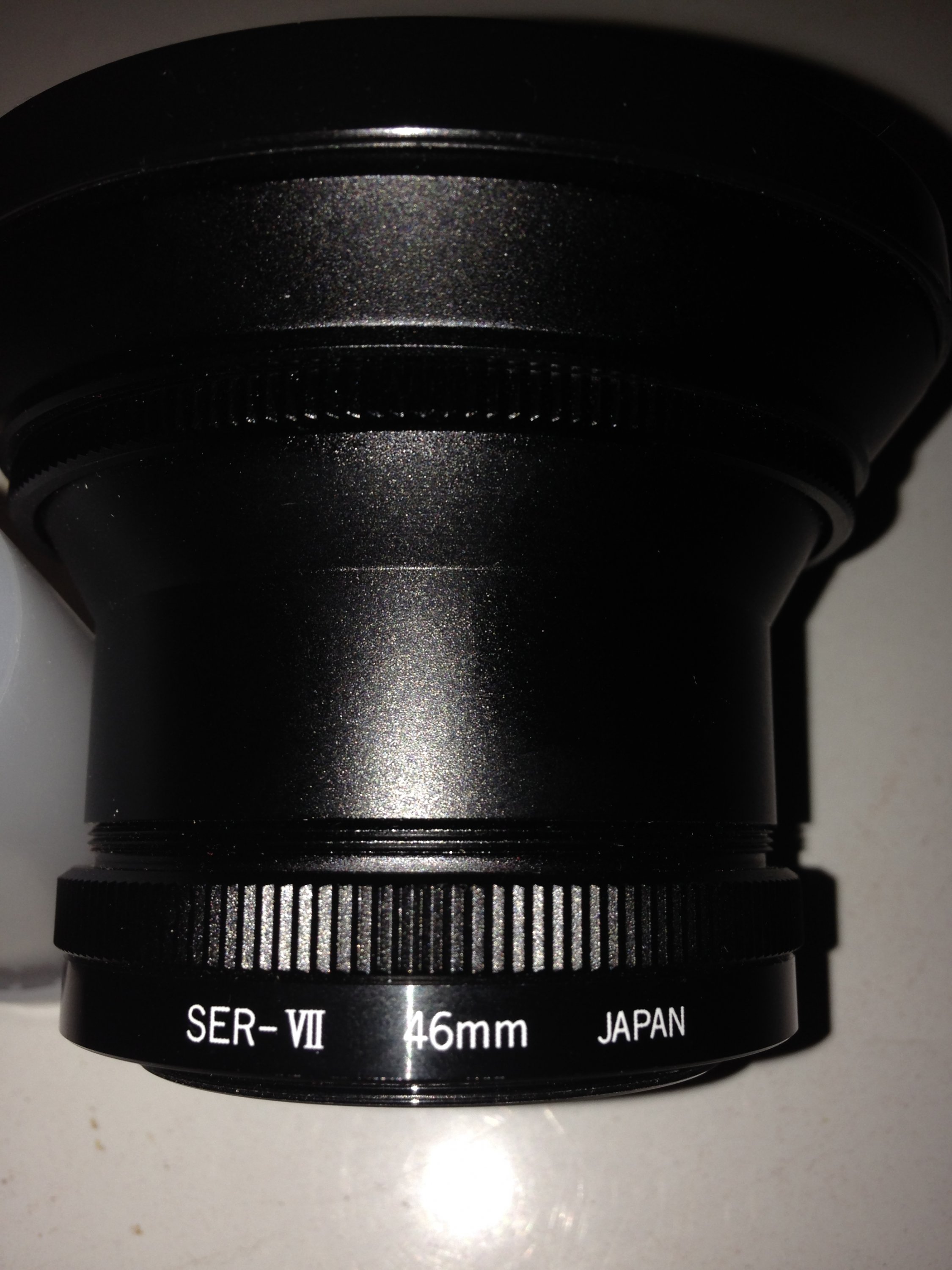

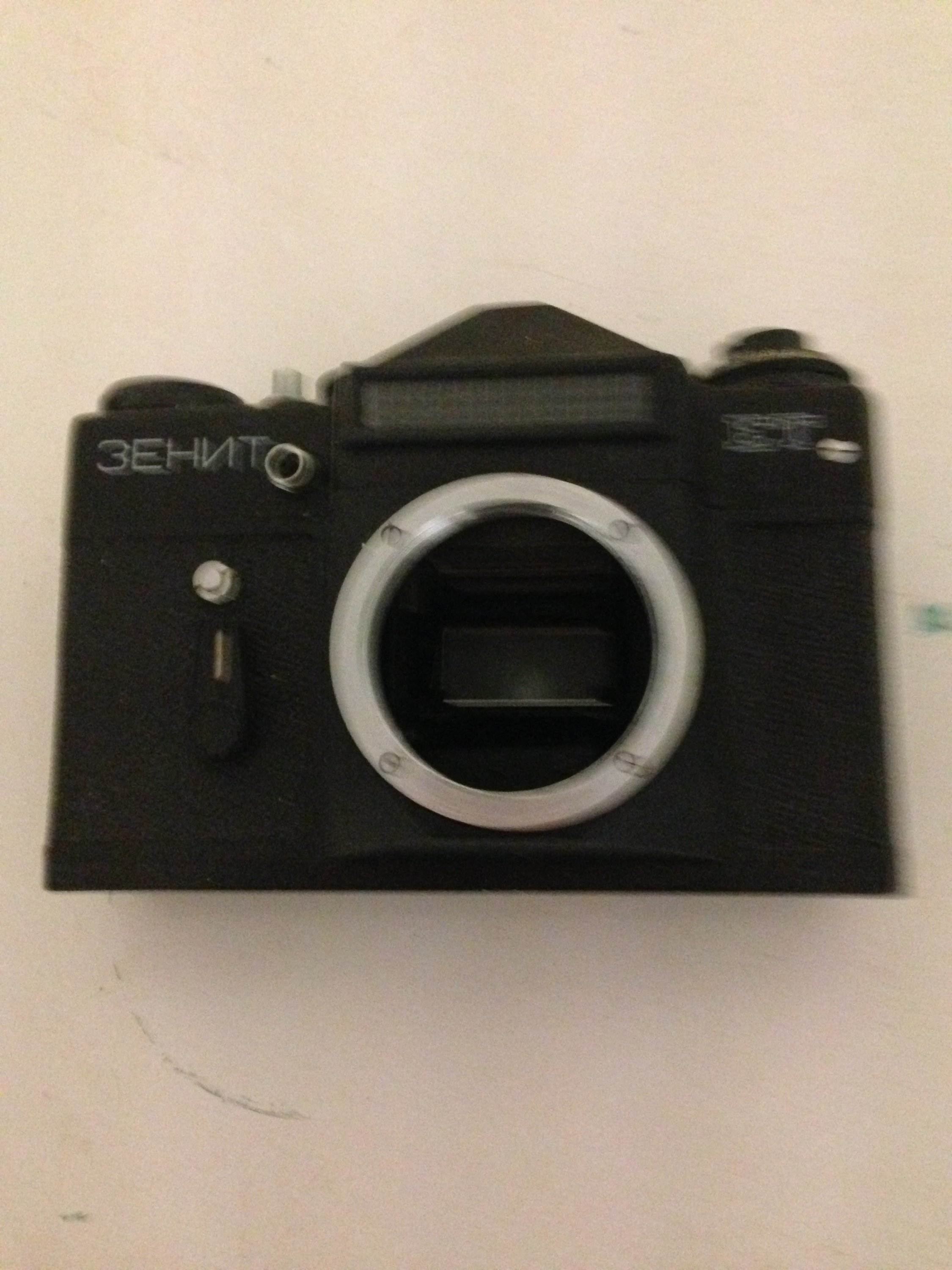

The camera is a Zenit. That's the Russian word for Zenith on the camera, but when exported to the decadent capitalist West the camera's name was changed to Zenit - I guess it was a Rushlish translation or they wanted to avoid stepping on the many 'Zenith' trademarks in the West.
The lens isn't a lens you can mount on a camera. It is a lens you attach to the front of a camera lens to give you a fish-eye view; sort of an overgrown version of a peephole lens you would mount in a door. Well that clears up the mystery of the '45mm thread.' If you get a camera lens with a 46mm filter thread you can use it - or you can get a series VII adapter for your lens' filter thread.
You need to get an M42 lens for the camera. Macro lenses tend to be expensive so you may want to get a plain-ole 50mm f2.0 lens (Pentax are probably the best, but there really aren't any bad 50mm f2.0 lenses) and the 50/2 lenses do a good job when pressed into macro duty. Get a set of extension tubes for macro work. You will also need a tripod and a cable release if you want to make really *close* shots - you can't hand hold them though just resting the camera on something to steady it sometimes works.

It seems to me now you are talking about mounting a close-up lens to the front of a regular lens.
In your photos you showed a wide-angle/fish-eye attachment lens to be mounted at the front.

Certainly no farce, if it provides an answer which is is in reply #10 from Nicholas.
It doesn't fit on a body. It fits the FRONT of a lens with a Series 7 thread. With a proper adapter, most any size
filter thread example 52mm->Series 7, 49-Series 7and any of the older fractional to Series that were around.

Not at all. The OP to own saying got a SLR and lens he wants to connect to each other. All sizes he states are erroneous.
Then he shows a M42 SLR and and a wide angle attachment lens, which not even got the thread size he mentioned before, nor can such lens, if anyhow adapted, form an image.
Then he calls that attachment lens a macro lens.
