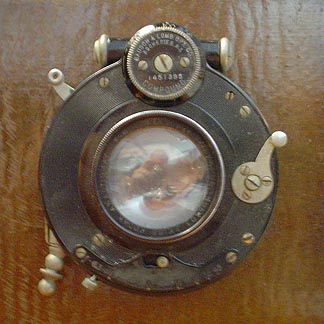

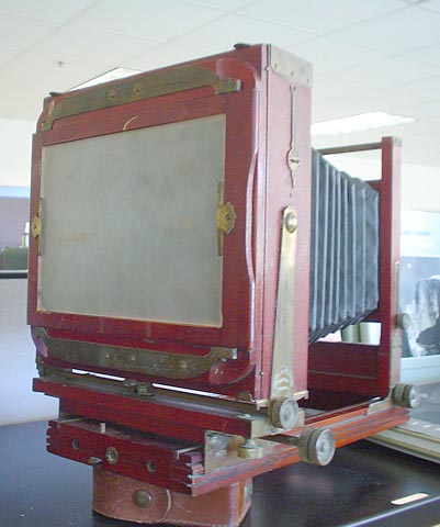

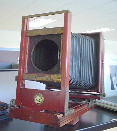

I recently won this Century No.2 5x7 and it came with a Zeiss Kodak Anastigmat f6.3 No.4. It's in a B&L compound shutter that fires well enough for me to send to Flutot's for repair.
Can anyone tell me the focal distance of this lens or anything else about it?
Thanks as usual :smile:
Alan.

What's to tell? Its a pre-US entry into WWI B&L f/6.3 tessar made under license from Carl Zeiss and sold to Kodak. Maximum aperture f/6.3, supposedly covers more and is in general better than if f/4.5 contemporary.
The best way to find its focal length is to measure it. Go measure.
I suggest this in part because based on my limited experience -- I have one in barrel, s/n 1733784 -- the numbers, e.g., No. 4, on "Kodak" lenses don't match those on corresponding B&L lenses as can be found at www.cameraeccentric.com. And I haven't found a Kodak-specific table linking "number" to format or focal length. FWIW, I measured my Zeiss Kodak f/6.3 #4 at 7" +/- a little.

Focus on infinity and measure from the center of the shutter to the ground glass.

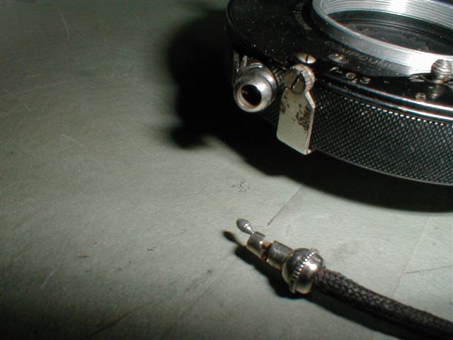

Our talented Carol at Flutot's has informed me while performing a CLA on this shutter that it takes a rather hard/impossible to find cable release. I was wondering if anyone had any ideas of what type it takes and where I could find one? See third picture on original post if you're interested.
Carol has been using a paper clip to test it but I think I might lose some street cred if I was seen using one in the field :smile:

Hard to see the picture clearly, but it looks like a simple air hose and bulb arrangement.

Alan, the 'cable release' will be a hollow tubing with a bulb on the end. Air trapped in said tubing and bulb will when the bulb is squeezed force a piston in the shutter forward and thus trip the timed sequence. This will please your onlookers to no end and folks with Nikon FM's and other similar ilk will say "Gosh, so that's where the 'B' came from"

Air releases for regular cameras seem to sell on e-bay for about £1. These have rather narrow tubing but you can make an adapter with a short section of larger tubing (available from aquarium suppliers, etc.). A little while back I was in a hurry to fix up a pneumatic release and bought a cheap blood-pressure gauge plus stethoscope set, which was slight overkill but yielded four pieces of tubing of just the right size and flexibility for use with a British "Day" shutter together with the bulb from a cheap secondhand air release. I am sure you will have no trouble making something suitable.

The Cable Release is not a normal type that threads into the release socket but rather is a bayonet that twists on into the release socket. Does that help clarify what he and I are looking for?

I presume then, that there isn't a piston on the inside of the shutter housing by that connection and that there is a "eral" mechanical connection happening. What was it you worked out for Nathan's Compound? Any possibility to do the same here?

The shutter release is a piston type (as Ilex, betax ect.), just the connection to it is different, like I mentioned above.

Here is a picture of the cable release, that we are looking for. This one belonged to another shutter that came in for a CLA.
Any Help!
