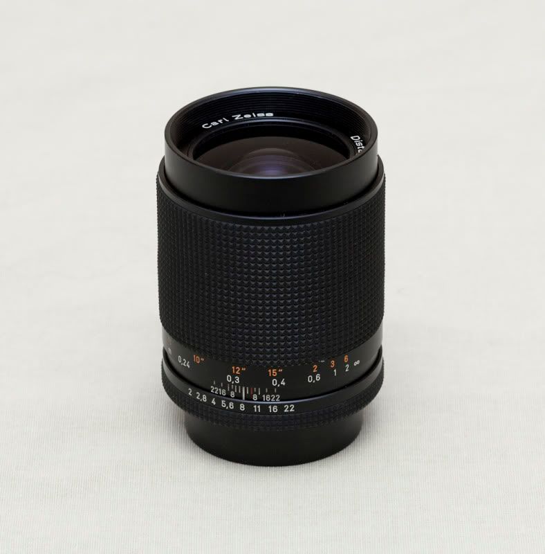

I don't have a Contax lens to compare, but I found this on the internet and it looks like the barrel is actually different than the Rollei.

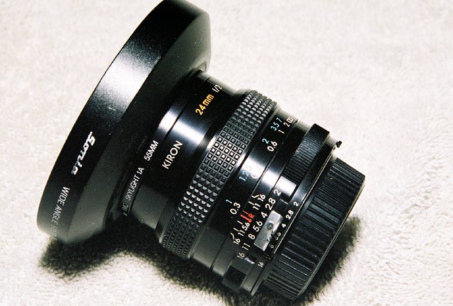

28mm;s are a dime dozen. Procure a Kiron f/2 version, and you'll never look back. Kiron (Kino Precision Industries) made excellent 24mm & 28mm f/2 lenses.
Looks like a sweet lens. So, did they ever make Kirons in Rollei mount?
