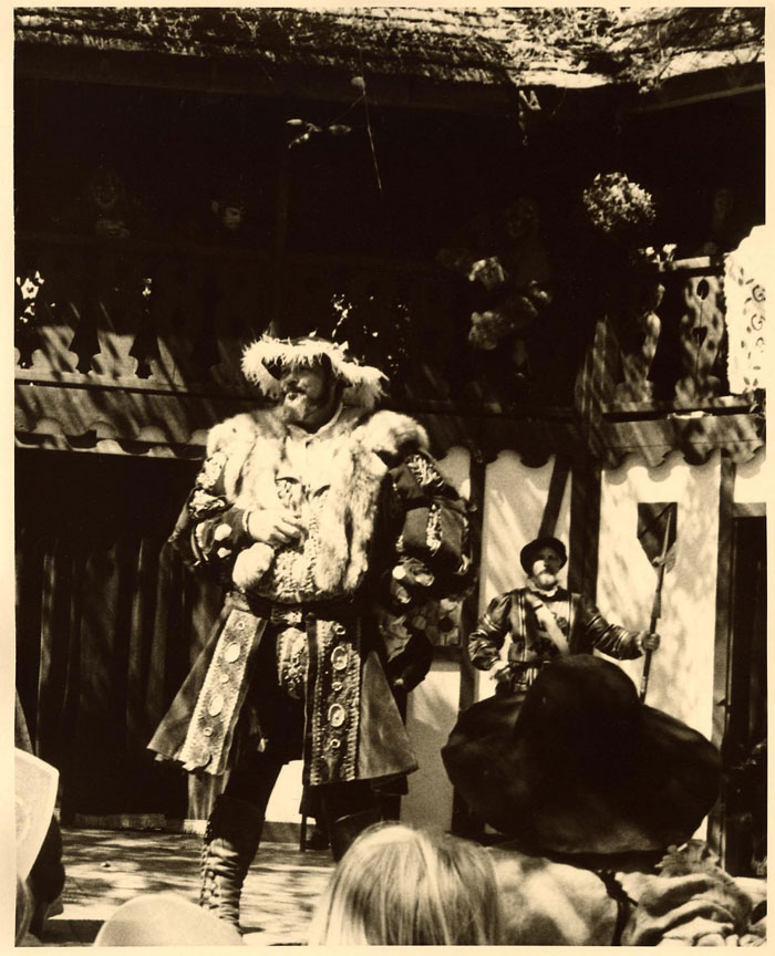

Also, I'm attaching a quick scan og the print I did. Film was APX100, exposed in Canon GIII QL17 (vacation snaps) on Auto exposure. Handheld exposure, holding the camera above the fop that was in front of me at the Texas RenFair and it was a typical bright day. Print is about a 14x enlargement of the central portion, printed on the Ektalure and processed in generic Dektol (don't ask). The actual print looks a bit more cream and less green than the scan.

Is it really so yellow ??? It looks like a toned print to me... My Ektalure prints have never been so yellow !
This is a toned (light selenium) print, so it is not green at all. But you can see that the paper base is just light cream, not yellow.
Made on 8x10 APX, contact printed on Ektalure G surface in Selectol Soft, then Dektol and finally Kodak Rapid Selenium 1+20.
Elox
Sep 18, 2003
90
Central Texa
No. For some reason, my scanner doesn't scan this paper well. It wants to make either too blue, yellow, or green.
