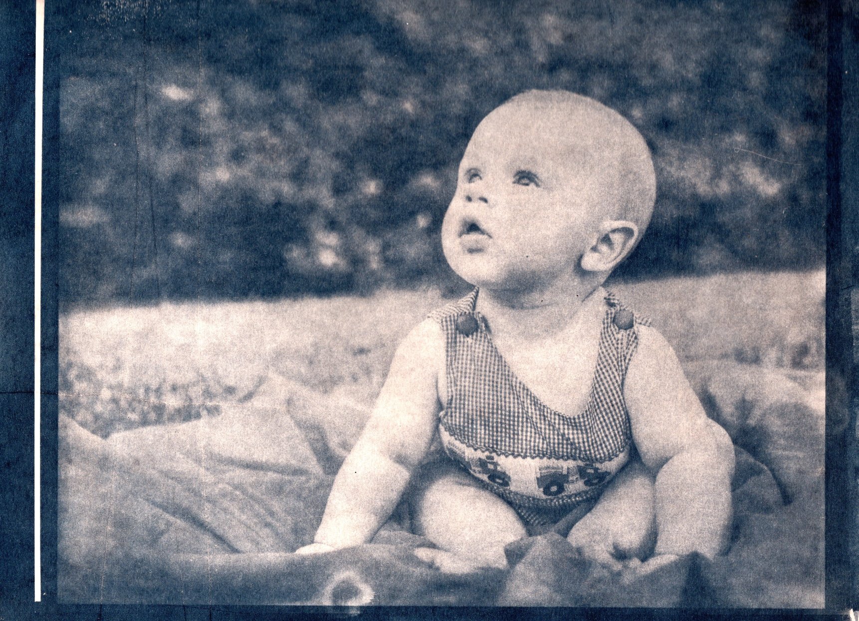

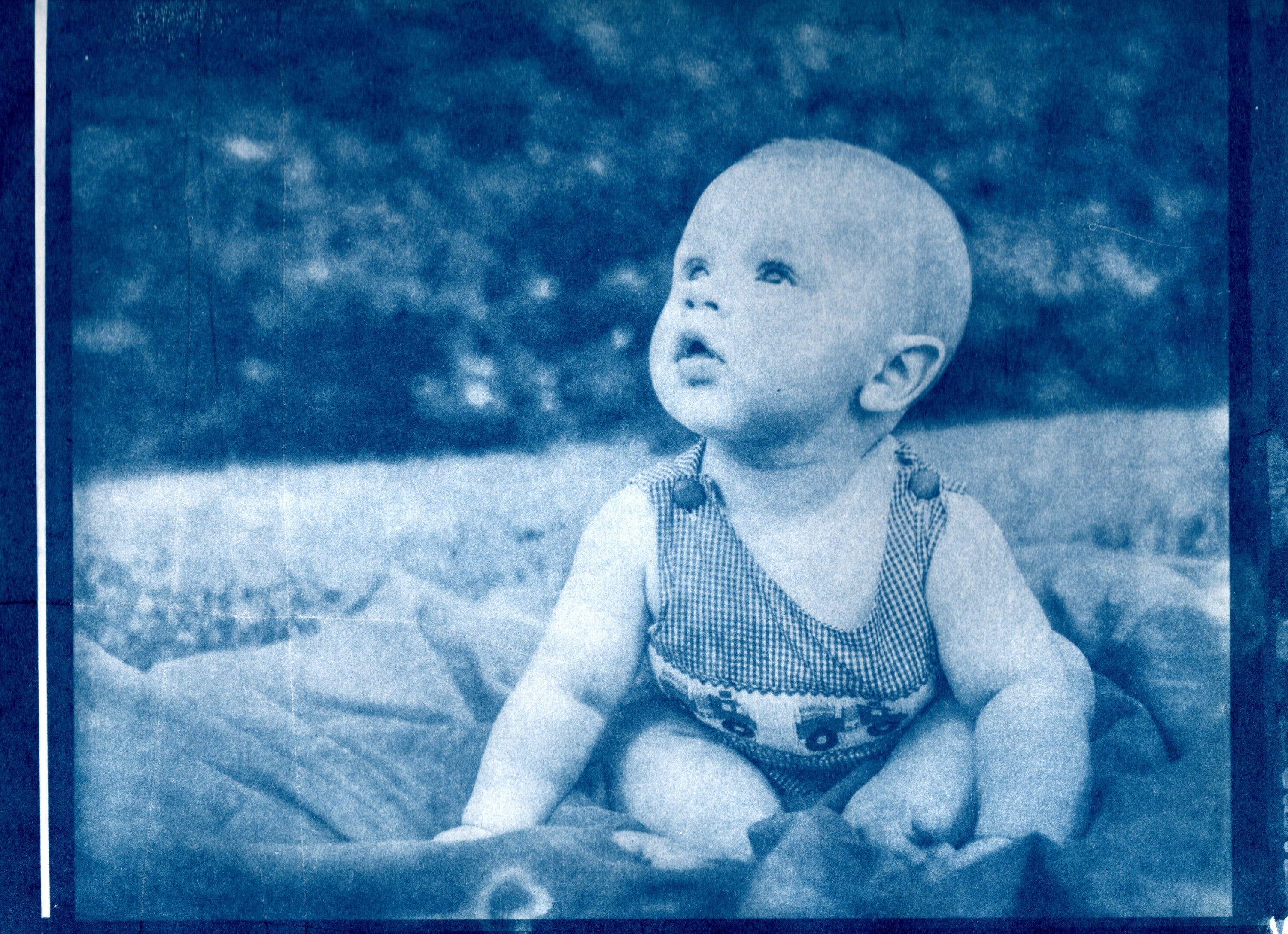

I thought my previous CT was a success, and it some form it was. However, I continued to get more and more frustrated trying to get good tonality in my cyanotypes. Add to that a pack of nearly wasted and very expensive Bergger paper, I was ready to cut ties with this process and try something else. After all, that is my nature - when something gets complicated, abandon it for something easier. But I stuck with it. I wrote my frustrations down in my journal, and spent a few days thinking about it.
After deciding to stick with it no matter what, I did some research and reading online. I found Mrhar's website and read about printing negatives in the best UV blocking color. So that's just what I did. I printed his color blocker, scanned it, and ran the analyzer. Turns out my negatives are better at blocking UV when their a funky, nearly lime green color.
Additionally, thanks to Christina Anderson, I found a cheaper alternative for experimentation, which I think I actually like better than Bergger. The Canson XL Bristol Recycled is about $9 a pack for 25 sheets, holds up to multiple baths, and prints a deeper blue than Bergger. It will be my paper of choice for the foreseeable future. As well, I found that applying the coating with a glass rod is much better than a foam brush.
I told a friends last night via email that if feelings were fireworks, I'm sure all of you could see them from here. I was incredibly excited to knock this print out. The first test left a little too much to be desired in the highlights, so I fogged this paper for about a minute before laying down the negative. To say that I am THRILLED with the results is an understatement.
I'll be attempting this one again later today and trying to tweak a few things that I think could be improved, but I am simply overjoyed with this result.
And the icing on the cake is that I didn't need any ChartThrob curves, or anything.

beautiful photograph ! and great story about problem solving and having a blast :smile:
can't wait to see how far down the road (or should I say out to sea :smile:. ) you travel with this fun process

Awesome! Congratulations!
It's always good to see some good experiences in problem solving. The "Aha!" moments never stop being good!

Hard work and determination paid off! I'm not familiar with this paper as I've always used acidified Stonehenge, and Hahnemuhle platinum rag (awesome paper!). Have you tried acidifying your paper?

I haven’t but it’s on the experimentation list. I have to research it first.

Agreed. I think it's finally set in that if I want to learn to do this, I need to take advice simply as a starting point, and form results on my own. And the only way to do that is simply to, just do it.

And then... you tone it in this mornings left over coffee, and it only gets BETTER!!
