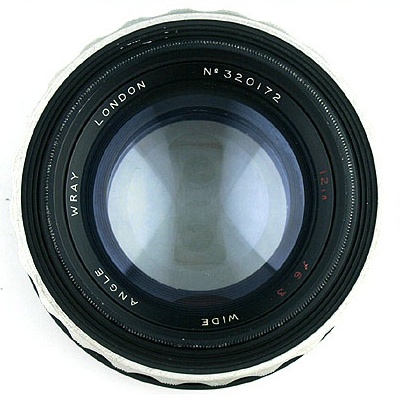

I recently came into a 12" f/6.3 Wray Wide Angle lens, and wonder if anyone out there is familar with it. The lens is in barrel, coated, and is 4/4 design, probably a double Gauss like the Wide Field Ektar. Coverage appears good: On my 11x14 the lens easily gives me 3" of front rise, and would clearly give more if the camera allowed. Using front swing to get to the edges of the light, I note that there is some field curvature (although much less than my 210/9 Computar) and the last inch or two of the image circle are not sharp, although they improve a bit stopped down.
I haven't found very much information on the lens, and would appreciate any knowledge. The Vade Mecum has a brief paragraph:
Wide Angle Anastigmat f6.3 89mm (3.5in) for 5x4, 7in for 1/2plate. See Wra013 This is in the same design group as the Zeiss Topogon, with very deep external curves and a thick walled Gauss layout. The 89mm version is a generous design. In use it covers 90° at f11 and 100° at f16 or less, or as the B.J.A. 1950 p212 found at f6.3 it covers a 1/4plate, (75°) almost perfectly, at f11 a 1/2plate with a little fall off and at f16 a 1/2plate is well covered. They said it would be ideal for a 5x4in camera, and: (a) it was available in an Epsilon shutter, but: (b) the illustration was of a lens in a barrel mount at No70,890 (advert. idem, p418) and these have been seen but are the uncommon version. (This coverage is a touch less than the Schneider Angulon and the contrast and corrections are probably a touch less good. But for many purposes the lenses are a close match. Users did find that the Wray had a lower contrast under difficult conditions and ultimately chose the Angulon as the more reliable. Today with multicoating it might be a closer run thing.)​
Anybody using or used one of these?

What an interesting lens ! Extrapolating from my WF Ektars, and the Cooke VIIB, you probably will get a 21" image circle at f/22. If you have a light source in the field of view, it'll flare if it is uncoated ( and I expect it to be ) but you shouldn't have trouble if you are reasonably careful. It's a great find. Have fun.

It is actually coated. A very nice blue color, like the sapphire blue I have seen in some later Artars. By the serial number, it was produced in the late 1950s to early 1960s.

Then you have a real gem. Shooting into a spotlight will surely flare... but for all normal work, should be a fine lens.

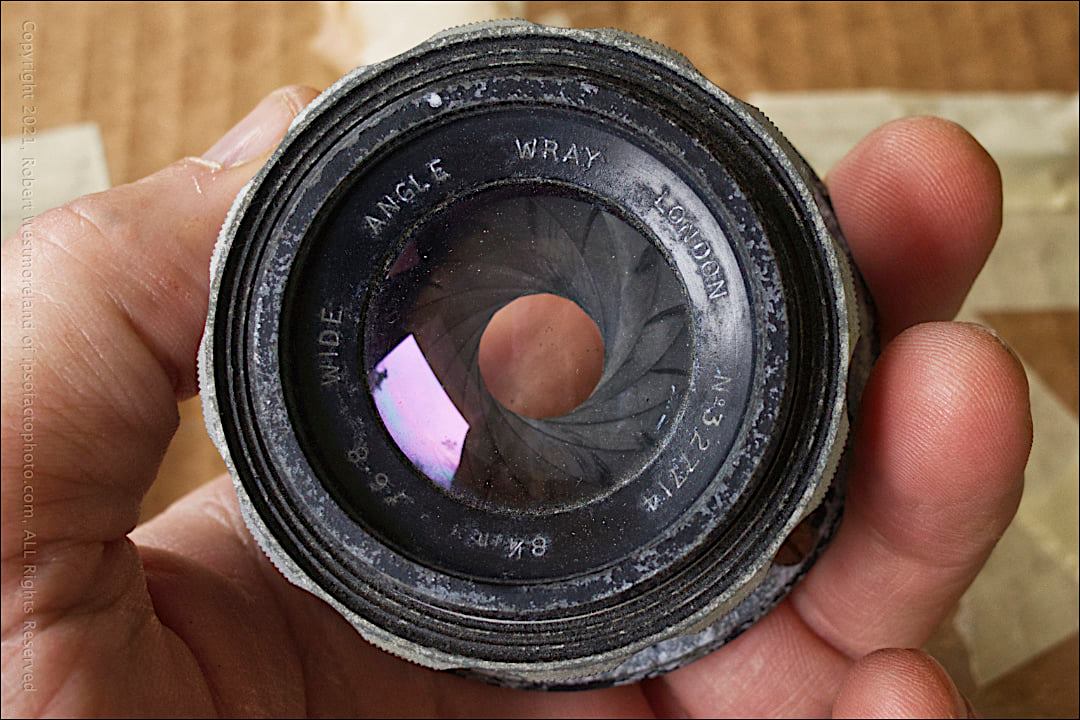

RDWestPR
May 25, 2014
23
Puerto Rico
Following the thread... I also have an old WRAY wide barrel lens. Mine is a 6.25" f6.8 with flange and was taken from a NuArk copy-camera used for litho work. The barrel is in real rough shape, but the glass is still okay. What I'm looking for is disassembly instructions so I can clean it up and repaint it. Minus the glass cells, of course. Any links to servicing WRAY enlarger lenses would be most appreciated. Lots of historical data, not much on repairs. Thanks, Rob
