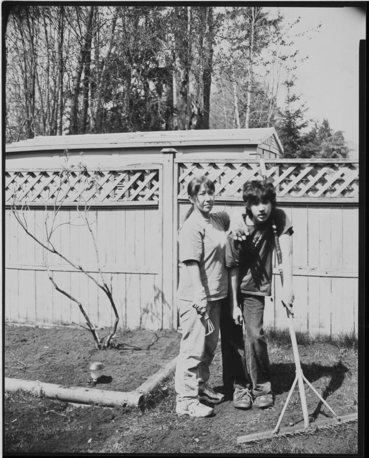

    I've used APHS 8x10 in camera. I shot it at EI 3 and developed in LC-1B (same as LC-1 but is a single solution. You control contrast by dilution).
    The attached image was shot last summer on a very sunny day. I believe the exposure was 1 second long.
