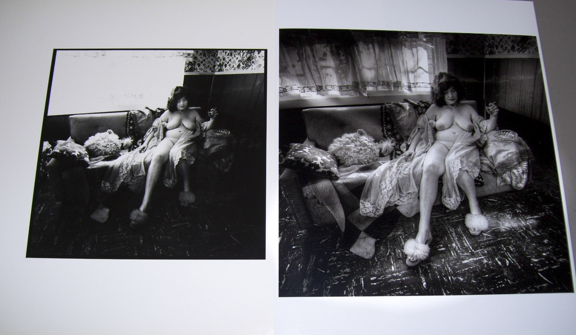

    I don't sell prints, I place them with museums and curated collections. Sometimes I note special printing info on a work print. With digital you can perfect the print image pretty much. It is not like wet printing. With digital you prefect the file one time. With wet printing you have to perfect each print in the darkroom.
    Sunlit Slipper 1973 Hassy SWC -vintage silver gelatin print versus inkjet print after 2-1/2 hours of Lightroom.
    I used to keep an album of 4 x 6 prints with notes on them, then gave it up. Switching media sometimes requires different printing settings, so I make a note of that.
