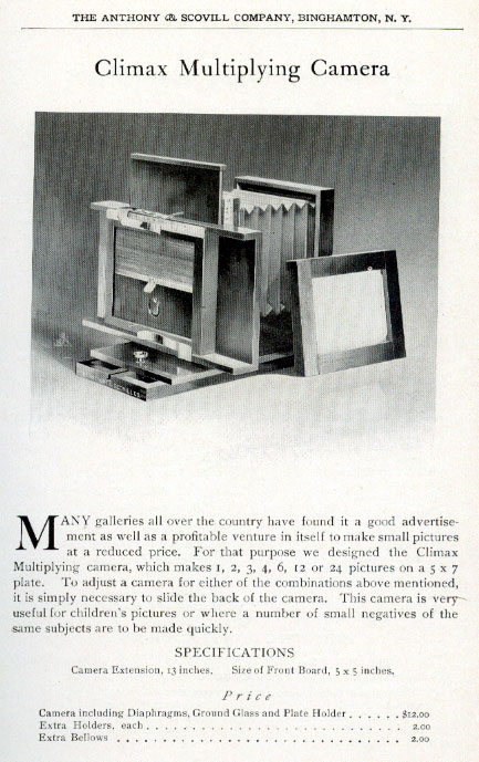

My guess would be a Scovill
Hi,
I found this thread from the link to my site. Thanks Deniz! I would have bought your ROC too, nice camera. I mainly collect the ROC line.
Photographica, Thats an awesome camera too! My guess is that it is an Anthony & Scovill "CLIMAX". Scovill & Adams used the white tags above the lens as yours has. It looks very similar to the climax model as shown in this 1906 catalog clipping. Advertised as being capable of making multiple images depending in the lens. It was packaged as a penny picture camea. hope this helps some.
Regards,
Tom
