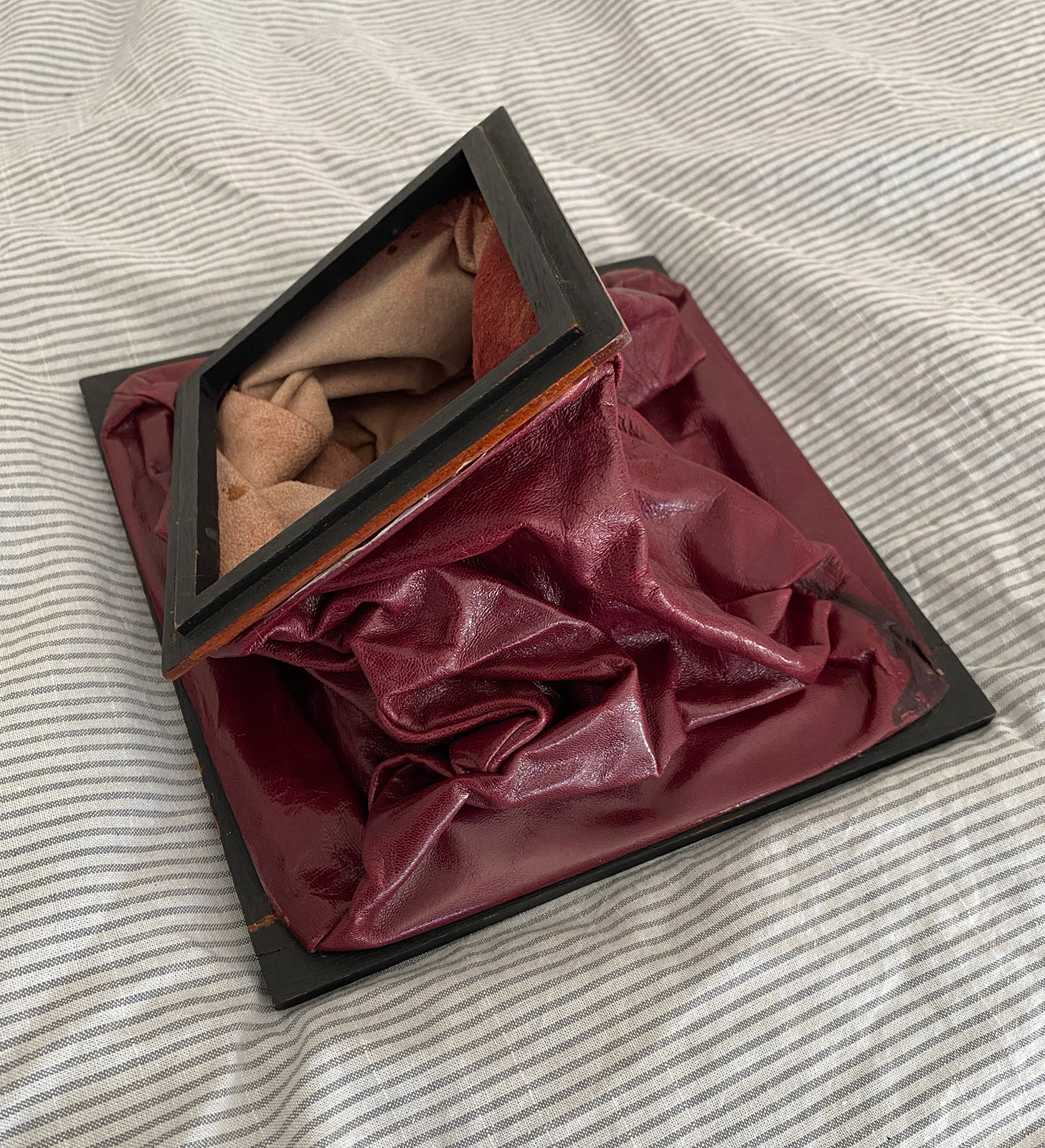

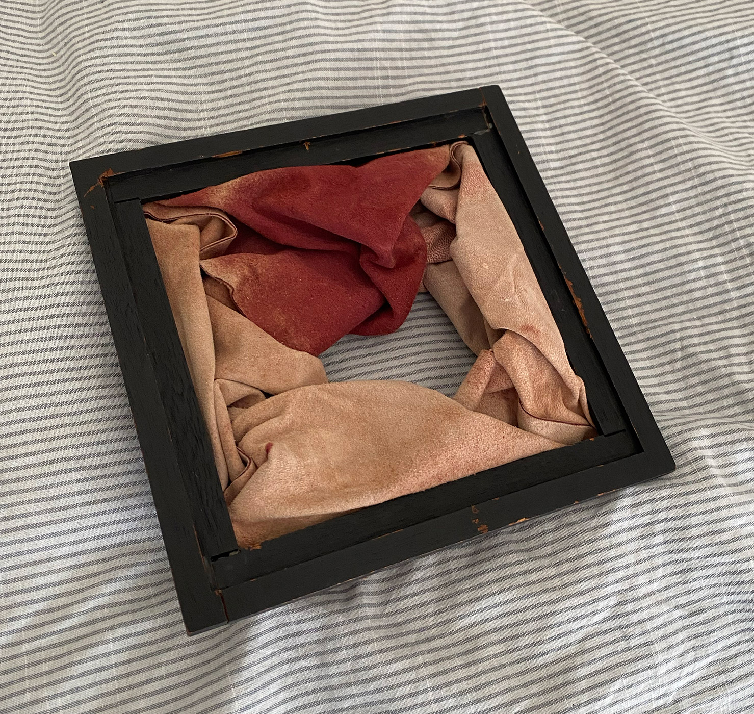

Hi Jim,
I made these for my Wisner 4"x5".
They're not the prettiest but they work very well.
I used very thin goat hide, it's the thinnest leather I could find and it's lighttight.
With hind site I should probably dye the inside black.
I can make you a set if you're so inclined.
Best,
Rory
