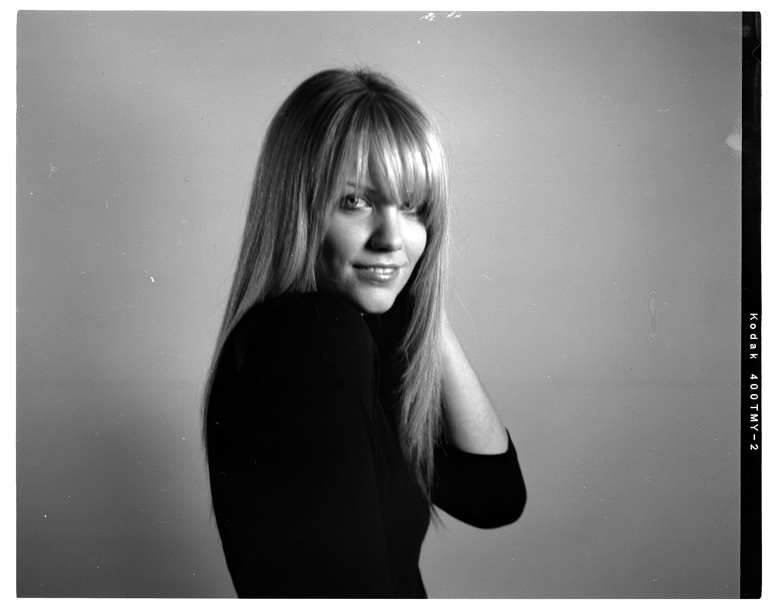

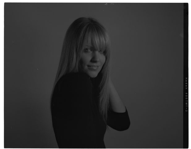

    the first one is a negative scanned with no editing. the second one was edited to show that there is still some detail in there. it seems like there is a salvageable print in there somewhere. i need to spend some more time in the darkroom playing around with it. i think my main problem is that i didn't chose a good subject for this developer. blonde girls in black clothes on white backgrounds are never easy to print. i'll have to get out a shoot and landscape this week and then i'll give the developer another try.

    If you have good control of lighting and exposure in the studio, the subject and developer should be irrelevant. Don't blame the chemicals if you haven't done a thorough test of the materials and how they behave. Your example looks underexposed and underdeveloped to me.
