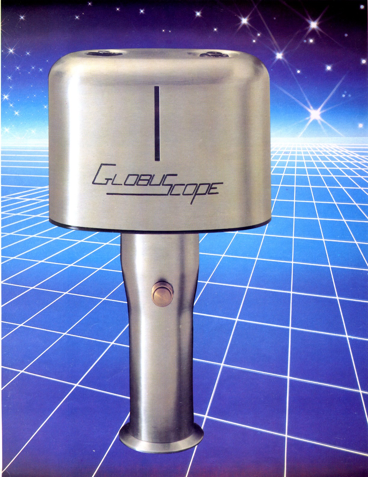

NB: just have seen an ad about the first globuscope-swiss seller 3k. 1/100, 1/200, 1/400 only.
