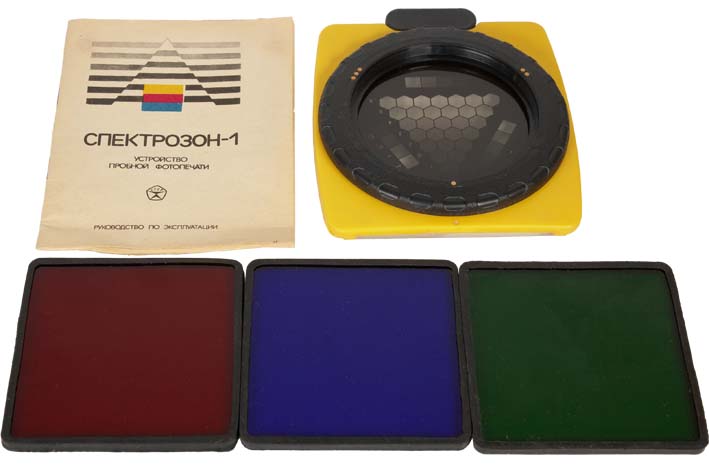

    The simplest answer to your first question is that: these values will give you max quality of image. The more theory on the deep roots of the problem you can find at the book of R. Hunt "The reproduction of the colour". But these params are not always have such values. The colour paper for unmasked negatives, produced in Russia till the beginning of 2000 years had starting values about 200 100 0. Last batches of Ilfochrome while it was fresh (2015) had values about 10 20 0. Some R-3 and other reversal papers - 0 50 20. You can try to find some China Lucky paper, which have red color of emulsion and it's starting values will differ from 50 60 0...to the redder range.
    The split contrast control in color analog printing is extremely difficult, but possible.
    1. You can try to play with developer temperature, custom developers recipes, different color developing agents, different papers and some methods of chemical correction. Probably it will give you some results, but nothing predictable.
    2. As you noted, it can be done by masking. The first thing you need to do is to forget about your CMY color head filtration. You need to get somewhere set of narrow red/green/blue filters for color printing, like these:
    [​IMG]
    You have to expose your image three times with different exposures through these. It still not give you what you want, but you will make a step ahead to your goal. The next stage is to pick up required b/w developer and make required mask or mask set at b/w film for required colors, then repeat process of 3 color exposures. After any one you have to pull out your negative from enlarger, apply a mask for the color and put this sandwich exactly at the same position in enlarger. It will require special frame with pins and there is not too much sense in this process.
