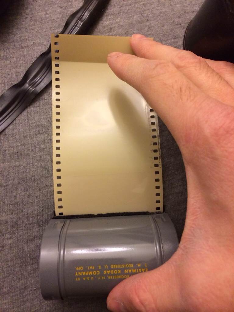

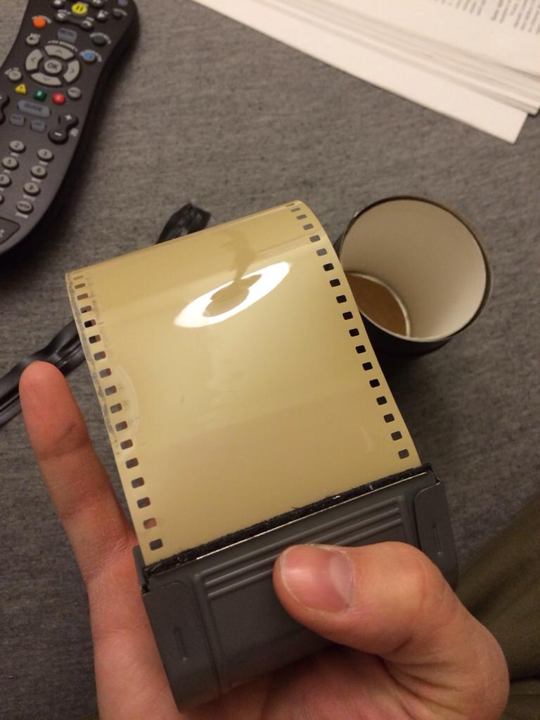

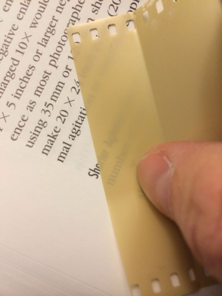

I keep forgetting to share these...
Examples of the "white" GAF film I have,
It's an eggshell white kind of white, it's white on both sides, seemingly the same color of white, and is semi-translucent as shown in the third picture.
Hope this is of some use to you.
